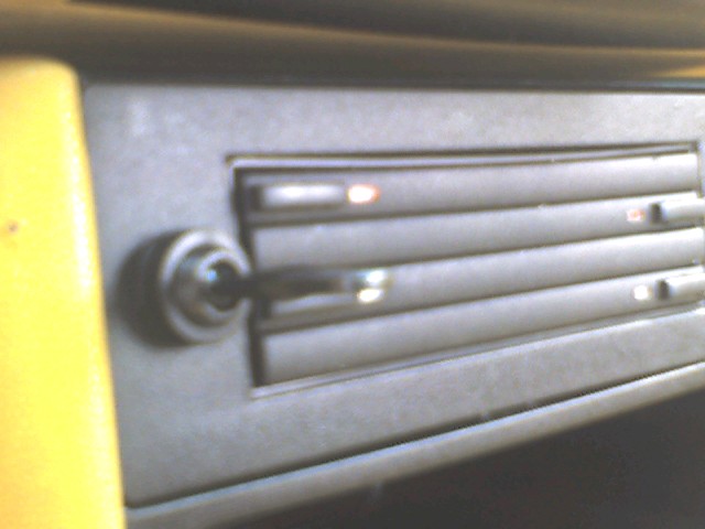

After learning what that switch on the fuse box does a few months ago i found myself reaching down a lot more to make the wing go up and down but it started to get annoying reaching down while im driving. Whenever there is a hot milf behind me or on the side of me i like to play with the wing to get them excited haha.Ladies dig the movement...But i figured just buying a new switch and relocating to a more reach-able spot would do me great so i got a switch for a buck and put it next to the cd holder,no more reaching down
You also could have gotten a Porsche switch that fits in your dash and is designed just for that....and it wouldnt look like you rigged it....
Its the middle switch in the pic....

Where did you get it?? And does it just plug into the harness that the fues box switch is plugged into now?
Dealer....Not sure how it plugs in, but is no harder than what you did. Your car may be prewired for it since its a Porsche option.

Wing switch
Does the switch also lower the wing at high speeds? Or only rase it at lower speeds like it does know at the stock location.
Old Apr 26, 2008 | 04:31 PM
All this does is physically move the switch.
The operation is the same. Push "up" button to raise, hold down "retract" to lower it.
Or, it does so based on speed.
-td

If you use this switch with the DIY it overides the automatic function when you use it. i.e. if you raise the spoiler with the switch it will stay up until you lower it with the switch. Once lowered it goes back to the auto mode.

Its Turbo Rear Spoiler Switch - 996 613 155 00 A02 "Glossy" finish
Turbo Rear Spoiler Switch - 996 613 155 10 A05 "Matte" finish
I installed the Glossy in my center console and I parralleled it off the bottom switch. So, I can use either one of them to raise and lower the spoiler. looks clean and lights up at night, like the other center switches.
