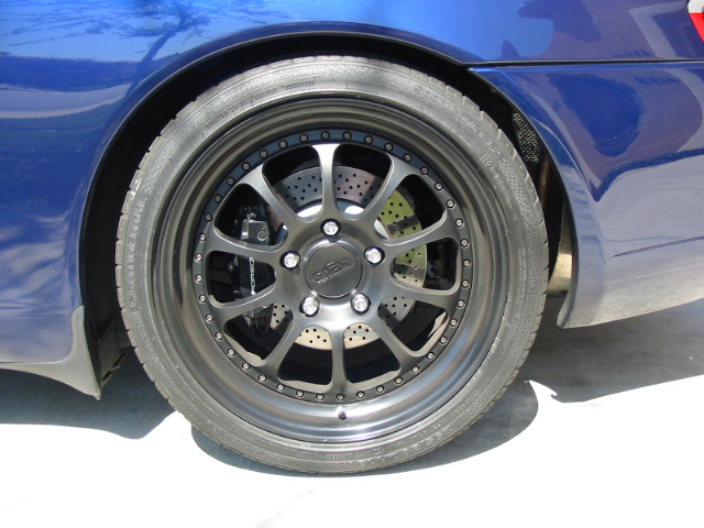

Can't advertise here, but here's a nice ball-park...

Here's a close-up of a Baked-In finish...
Orange peel is going to show-up if it is Powder Baked... I personally paint the wheels as I would the hood of a car. No one stage shooting here...
