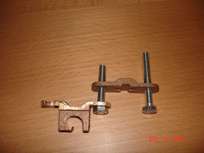

So I went down to Home Depot today and walked the store for an hour or so to brainstorm ideas for a DIY camera mount. As it turns out, I found a PERFECT mount - for $2.79. It is a 3/8" grounding clamp found in the electical department. It looks like this:

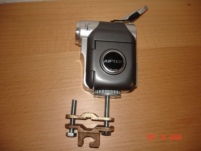

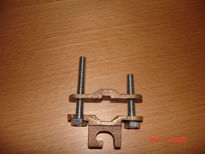

As it turns out the screws/threads used on this clamp are EXACTLY the same size as the standard camera mounting hole. How convenient. [It actually came with screws that had a head for a slotted screwdriver, but I switched over to some hex head ones I had lying around.] Pictures of the assembled mount:

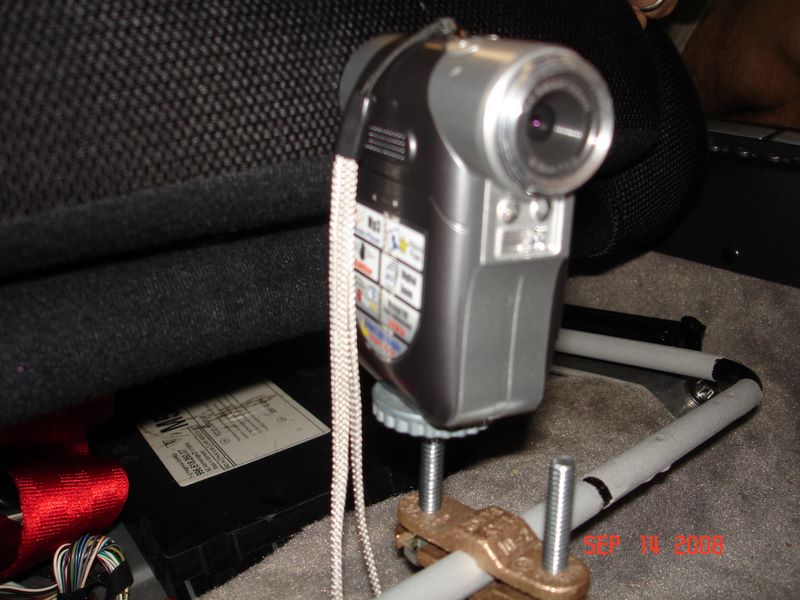

No extra work needed - the camera simply screws onto the exposed bolt. I did add a round disc that I had from an old camera mount - but you could use a hex nut instead. This does 2 things: it adds a little stability to the camera and allows you to get the camera pointed in the right direction and then "lock" it down from underneath the camera.

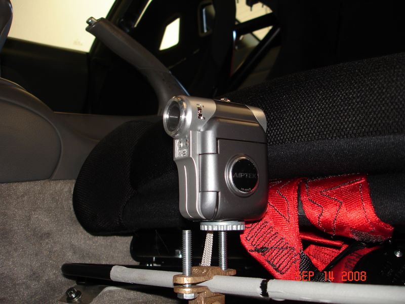

I have Cobra Imola racing seats with standard pull up bars to adjust the seat. I simply added some racer's tape to the seat adjuster (pull-up) bar, and mounted the clamp directly to it. I positioned it so the camera is directly in the middle of the bar. Set up this way, the camera is unobtrusive and does not interfere with driving.
