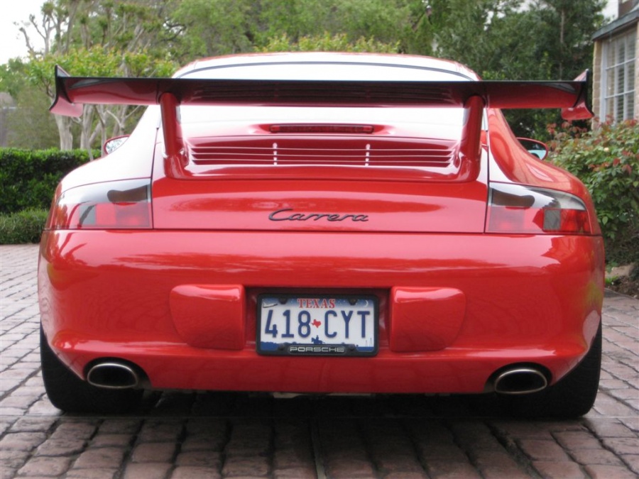

I have tried to read all I can on the topic of suspension and wanted to throw out my scenario and see what comes back. I have a 2000 C2 Tiptronic with 110 k miles. The car came with standard suspension but the PO replaced the springs with Eibach lowering springs from Champion Motorsport. The car was a little too low for the road hazards I deal with, suspension was fairly harsh, and I would get spring binding (clanking over bumps). That was how it was when I bought the car with 70k miles. I replaced the springs with US M030. Ride height is better for my roads but still seems a little harsh compared to new Cayman's I have driven as loaners. When I replaced the springs I noticed one of the rear shocks leaking. So I probably need new shock and struts anyway. I just wonder if new shocks will make any difference over sharp impact bumps. I assume that if the shock is gone then there is no compression damping and thus the only resistance to the impact is the spring. If I replace the shock there will be spring plus shock acting (do I have that right)? I would like better control on cornering but this is my daily driver and I very rarely track the car. So suspension compromise for the street is unacceptable. I have thought about PSS9s or even JIC (little pricey but more adjustment). However, the JIC set up uses pillow ball mounts which I assume will translate pothole impacts into the car. PSS9s are nice but I doubt I would ever need the adjustment. I probably wouldn't bother lowering the car much anyway (leave at highest setting which I assume is already somewhat lowered compared to standard). So that leaves me with 3 options from Porsche, standard, US M030, and ROW M030. Again, lowering is not a prime concern. I know I will get a lot of slaps for this but "comfort", then followed by cornering precision. I accept that even with standard suspension this car is way beyond my limits. Should I just go with stock suspension all around (maybe change the sways?). Or how about the ROW M030? Are there any old farts like me out there who realize that I am not really a race driver and this car can be the perfect compromise for all I need it to do? Anyone try the ROW M030 and think. "too much"?
Let me characterize harshness as loud bang's in the cabin over potholes. Sound proofing might improve that. Seems like the newer cars are quieter than my 9 year old car.
I appreciate all "positive" responses.
