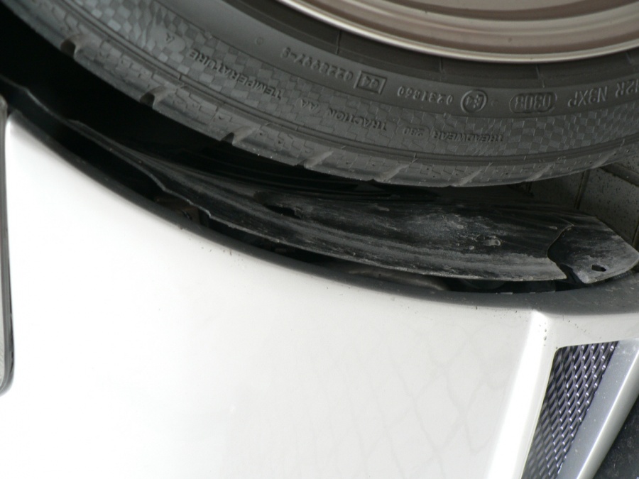

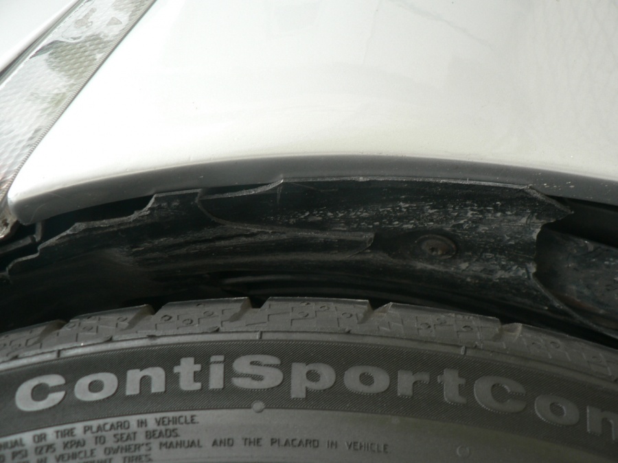

Hi Guys!
Can anyone tell me what is the part number for the plastic front wheel housing liner for a 2002 996 C4S? Pictures attached. Thanks!

There are a couple of pieces for each side. the larger piece is 996.504.203.08 left and 996.504.204.08 right, the smaller piece is 996.504.123.00 left and 996.504.124.00 right. These numbers are specific for the C4S.

Thanks! I am looking to get the smaller pieces. These are the exact part numbers given to me by Pelican Parts, but they couldn't be sure. Do I need to get any accompanying nuts/bolts?

Ha no, I dun do any mountain trekking in my 996! The plastic liners were ripped off by my incompetent kitman who was trying to fit up my front bumper.
