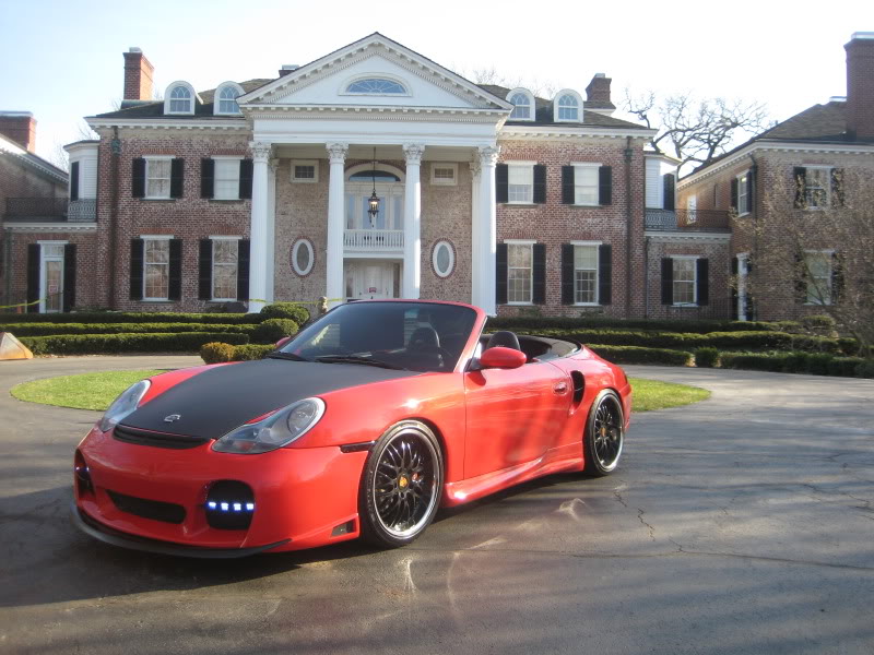

1/4 inch fronts 1/2 inch on on rear

Thumbs up ......
Originally Posted by Omarcoolguy
Omarcoolguy - looks great - how much is your car lowered?
Cheers...!
nice ride man,,
what are the wheel/tire sizes?
got more pictures for your car?
