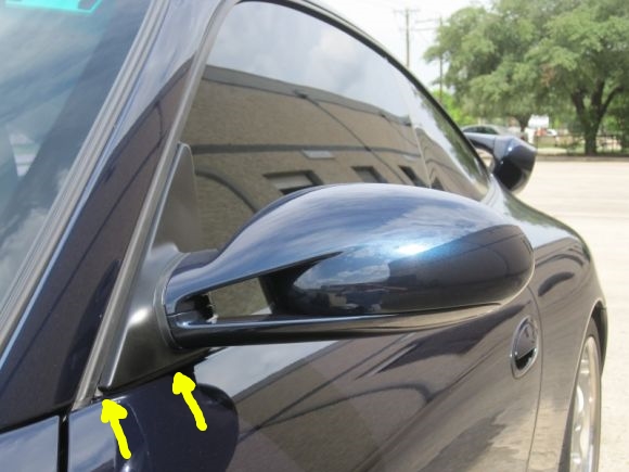

Originally Posted by MkC2
Well I guess nobody knows the answer from my previous thread if a 997 side mirrors fit on a 996 body....I saw a pair of 997 mirror on ebay & I decided to buy it on an impulse not knowing whether it'll fit or not....Let me be the first to tell you...HELL NO IT DOESN'T FIT....The mounting holes & connector plug does not lines up right...I wasn't about to let all that $$ go bye-bye so I was determined to make it work...One good thing was that it plugged right in to the oem connector...The mirror moves in a wierd direction but who cares as long as it moves...One of the plug mounting hole need to be bored out & the side trimmed inorder to lowered the plug down..I drilled 2 new holes & enlarged 1 existing hole..This was not an easy task like I thought it would be, but at the end I think it turns out pretty darn good...
here's the final result:

Originally Posted by Col64
Hi, I'm in the process of doing the same mirror conversion, can you tell me, did you change the rubber seal that the mirror fits in on the door or did you use the original ones, any help would be really appreciated, thanks
if you're using Oem 997 mirrors & not the aftermarket one, the rubber seal should fit with minor trimming. I did not use the original one...you may need to cut away bottom rubber trim so the mirror can sit flush..
yellow arrow is where you need to trim..save that piece just in case you want to put the old mirror back
it will sit flush like this
there will be about 1/4" gap so all you need to do is cut yourself some rubber piece & tuck it in....hope this helps & G/L
