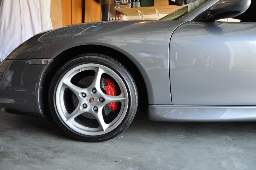

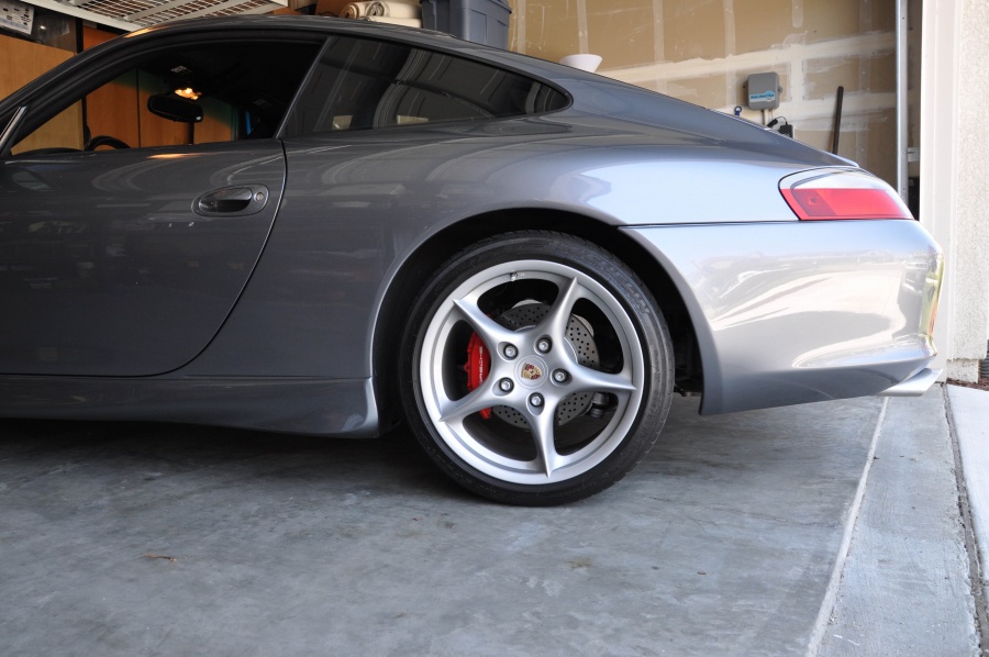

Well I finally got some time to put the K-Sport Coil over in. Thanks again to Michael at Acute Performance for getting the parts to me quickly and the good deal.
The job was pretty easy and straight forward. I would say start to clean up was about 3.5 hours doing it by myself and with adjusting the ride height.
I am happy with the look - dropped it about 1 7/8" - ride feels good for the brief test drive I took.

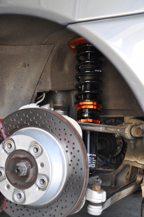

Only issue I had was the rear shocks - the 3 bolts on top stock at 10mm 1.50 pitch and the K-sport are 10mm 1.25 pitch. Wish they would include the new hardware - had to run to the store to get 6 new bolts (included in the time above). On other thing to note is the fronts do have built in camber plates - but to adjust them the front shock towers need to be lowered off the body as you cannot adjust them once they are on the car.
I will keep you all posted with long term driving impression and durability.

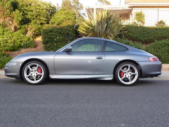

Here are some pics also - I only had the front after shot - I will update with full car pics soon!

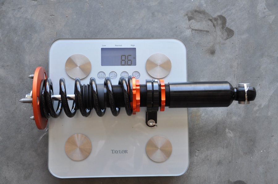

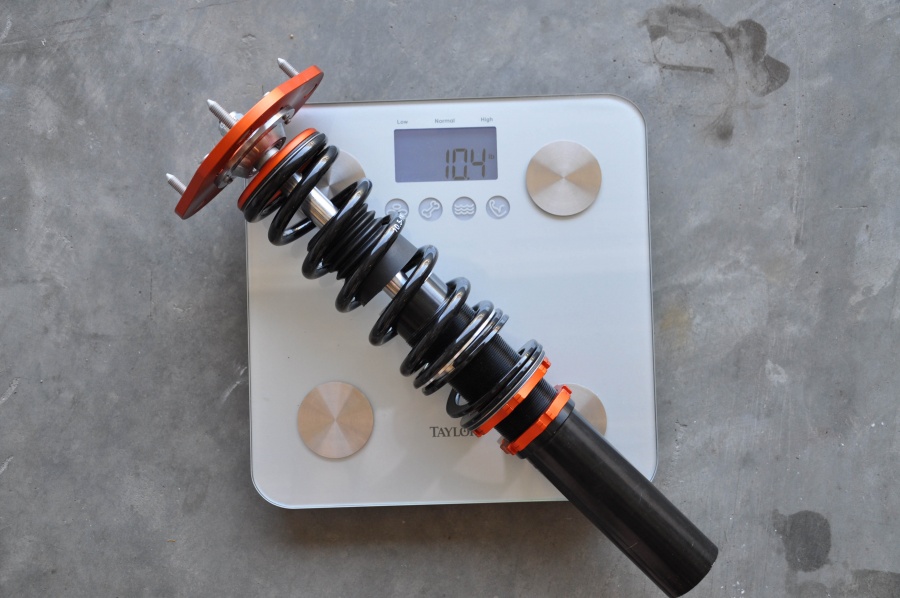

Out of curiosity I weighed the K-sport front and rear - I will update with weight of stock suspension.

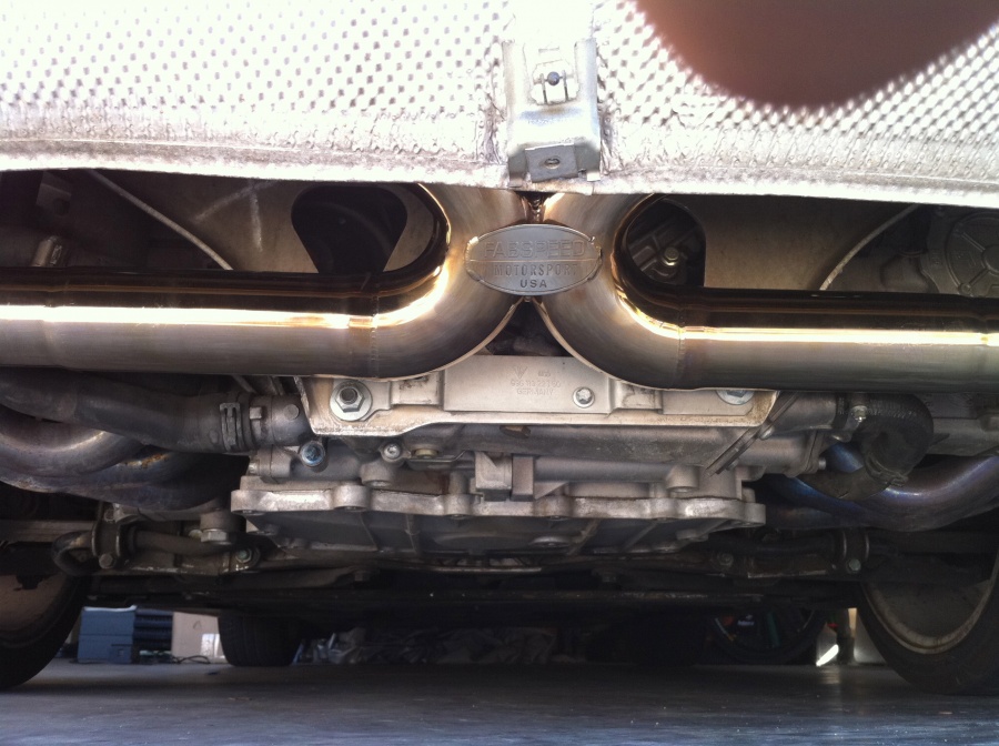

I also installed a FabSpeed Cat delete x-pipe (thanks Dan @ Vivid!). Stock cans weighed in at 14.5 lbs each so I saved about 25+ lbs. I am happy with the sounds and performance. Probably the best bang for my buck so far. Lost some low end - but once it hits 3500 RPM it comes on good and pulls VERY hard to the top. Over 3 hours of driving and no CEL yet
Here are some pics before and during install:

Great! I'm glad to hear it all went well. The allen nuts on the camber are 5mm, if you get a ball head allen you can adjust the camber without fully dropping the suspension, you simple just unscrew the top 3 screws and lower the suspension and you can get to them.
How many clicks are you at right now?

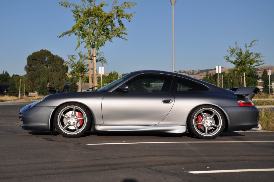

snapped a photo tonight. Here is a pic when I bought it and now:
