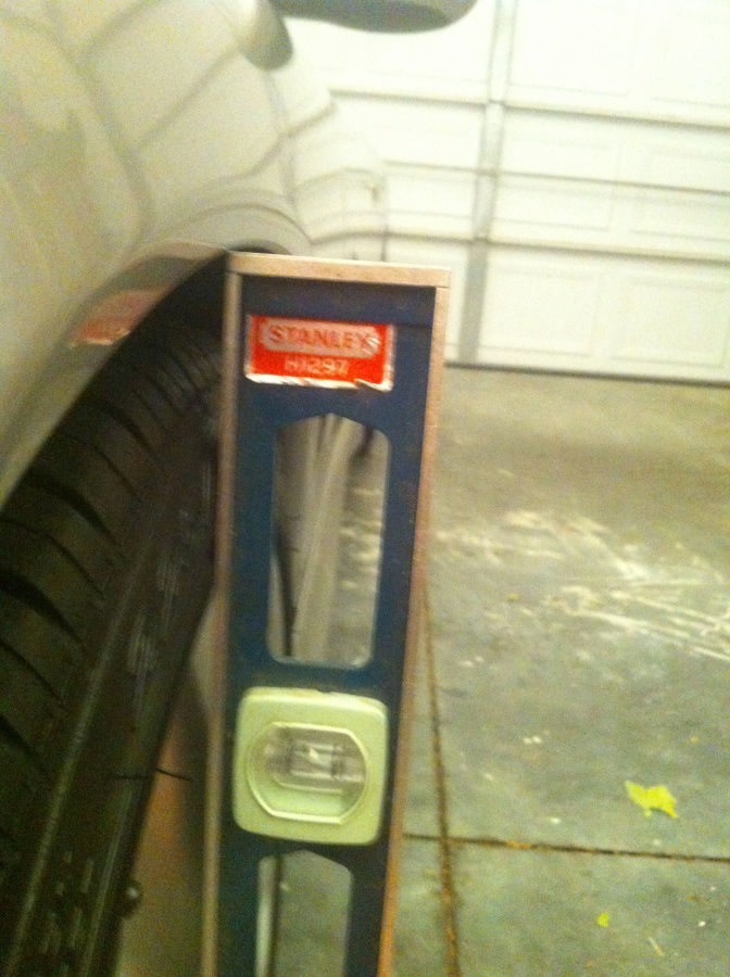

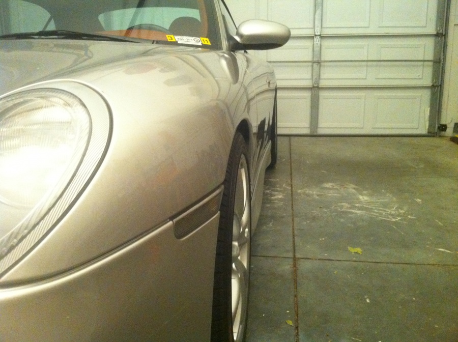

OK, I just went out and took these with my iPhone. I hope they help. It's hard to judge with pictures so I put a 2' level up the wheel to show how far the edge of the wheel comes out relevant to the fender.

That looks nice. Are you lowered and what camber do you run? I'm on H&R and -0.8 camber in the front.

I only have H&R lowering springs and no customer camber, nothing special.
