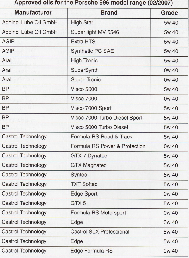

The attached are from "the 996 essential companion".
Have at it.
