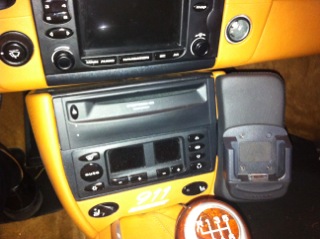

I am using one of the FM antenna hookups in my 2000 with a PCM-1 head unit.
I think it works and sounds great.
My iphone 4 sits snuggly in a dock mounted on a Kuda.
It took me <1hour to install, once I had my parts and a plan.
When I get home I will post the pictures and the parts.

pictures of install
here are two pics of the unit and install

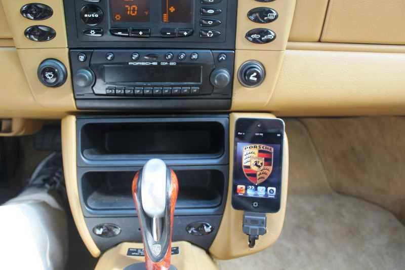

Here's a photo of my set up. The iPod Touch is just velcro'd on and is holding up very well. The thick trim piece on right side of the console came with the car. It was used with the factory cell phone bracket. I originally removed it and replaced it with a standard trim piece, then put it back when I bought the iPod. I'm not sure if this set up is permanent yet. I would prefer a bracket that lets you swivel the iPod so you can take advantage of it's widescreen functions. The iPod touch has built in WiFi, so I can check email and browse the web while I'm waiting for my son at the train station. The sound is amazing compared to the FM transmitter that I tried first.
When turned off, the iPod is practically invisible from outside the car, which is nice. It's still easy enough to remove, but not necessary.
