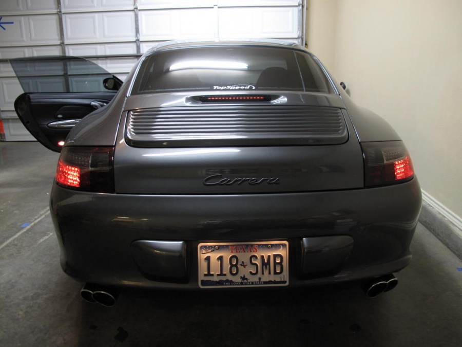

So I made all my testing by turning ON and OFF the light switch and all was fine..
But now that I test it with the ignition key in and ready to start (or if the engine is running), my third stop light is turning on ....
Note1: that I have a LED third brake light kit installed, so I wonder if that picks up some low power that is usually in the system but not enough to lit up the blb version or... if I have another short somewhere
Note2: the picture is taken with the lgiht switch on, and the key in the on position. But I do NOT have my foot on the brake pedal.. I am taking the picture
