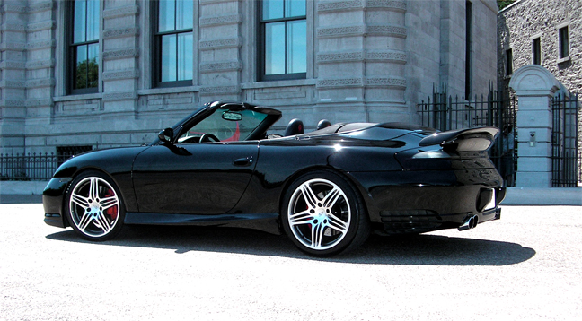

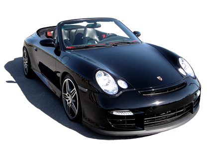

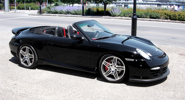

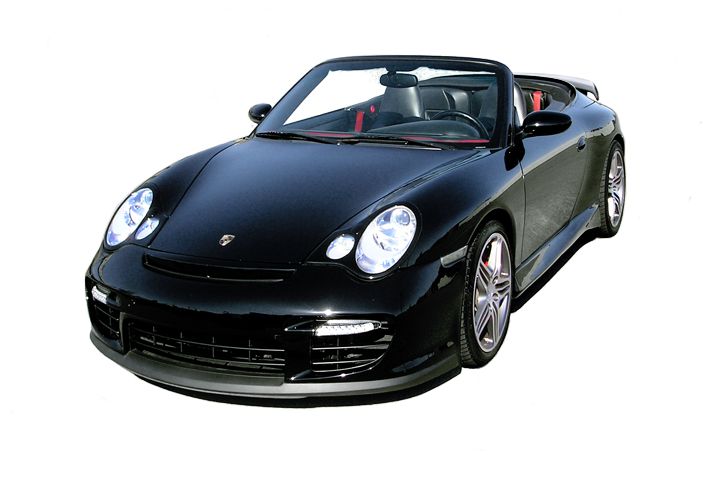

I did a full write-up on this dumper for another 6speeder. https://www.6speedonline.com/forums/...ml#post3047872
Here's a copy/paste of that.
I've bought a front bumper for my other P. and the side skirts on this one from Precision Porsche and have been happy with the quality and service.
Would have bought the GT2 bumper from them as well but they didn't carry it at the time (not sure if they do now).
Here she goes...
You've got to do fiber/putty work on the tow-hook cover, the outside points where the bumper sits against the light, re-enforce the anchor point by the pumpkins (after shaving those down) and do a whole bunch of fitments, cutting and drilling for where the LED's go, the lip, grills, attachment by the hood etc, etc.
Than you've got the priming, sanding, painting and clear-coat before the final assembly, now because every surface curves in every direction block sanding is basically out... which means chances are pretty good you'll find some waves in the surface (of course after it's been installed) which means (if you're a psycho like me) you've got to have it done all over again!
Now that was with my bumper which is a high quality one (from Wicked Motor Works) it cost me about 5K with the oem led's, grills and lip + shipping and brokerage.
Also you'll absolutely need to have the oem lip cause it's very forgiving, like Alpine003 said the fiber-glass one is a disaster!
Because the bumper is fiberglass you'll also need to have an M3 film installed on the bumper, that works like magic and negates the negative attributes of the fiberglass, however since there is no M3 computer pattern for this Frankenstein bumper it has to be hand cut on the car by a very, very skilled professional (read $$$).
If you're going to spend this kind of $ on the labour for a bumper you might as well bite the bullet and go for the one I got (of course you still have to add the cost for the electrical of the led's).
So if you're still interested I know Wicked Motor Works do have a 997 GT2 bumper for your car, in total it cost me about 10K
It gets complicated and expensive but if it was easy everyone would be doing it!
I know it's sort of a crazy thing to do...but what a ride!!!!
Good luck!
Sid.
