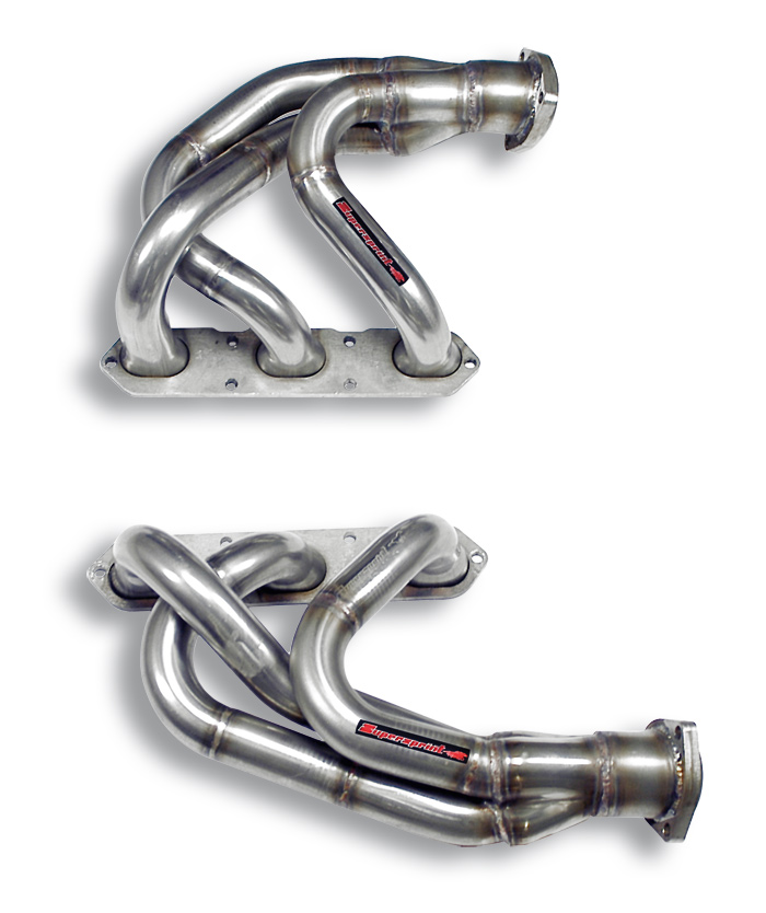

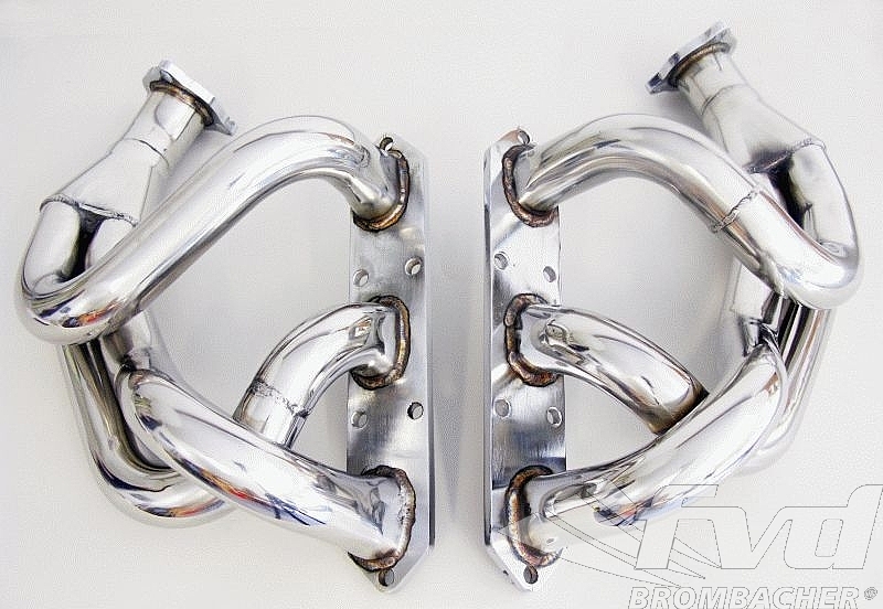

I am looking for buying headers for my 4s. Looking the net and see that FVD and supersrint is very similar look the photos. why pay double for the superssprints...

The 2 key elements to a good header is the tube length and the merge collector. While I can't speak for the Supersprint headers I can tell you that the pipe length seems to be very similar between the 2 from the photos. The FVD headers have a pyramid style merge collector to smooth out the exhaust flow going into the cats. Headers are really for mid range torque. If you ask me, that is just what a 3.6L 996 motor needs more of. You will see torque gains betwen 10-15 NM between 2,500 - 4,800 rpms. Then you will also get about 10+ hp in the higher rpm range as you have freed up more exhaust backpressure.
