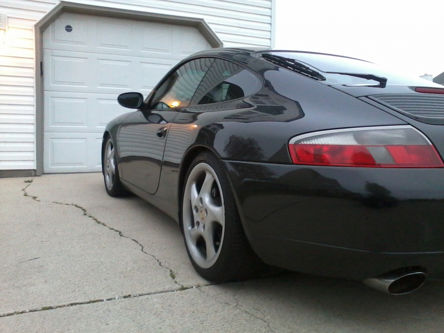

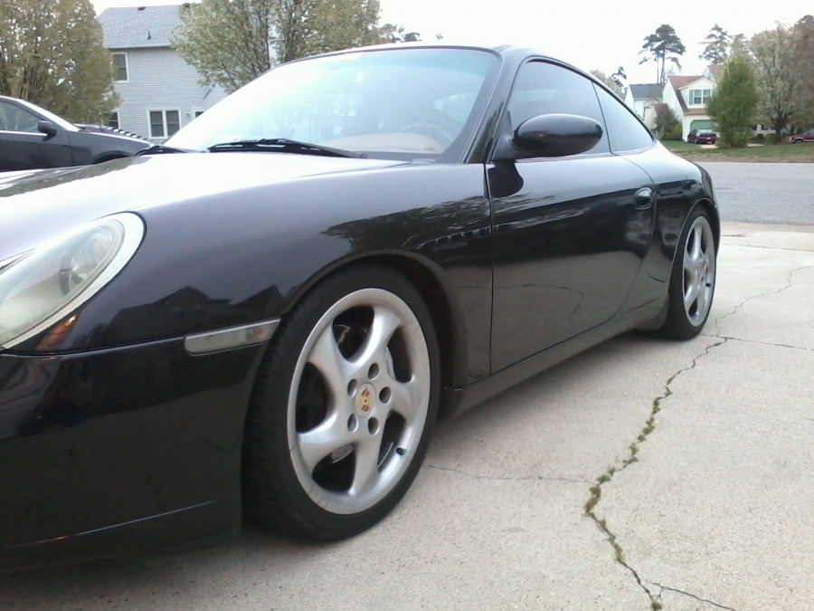

Hope this helps... C4 lowered H&R, rear 15MM on turbo twist (stock) nothing on the front...
