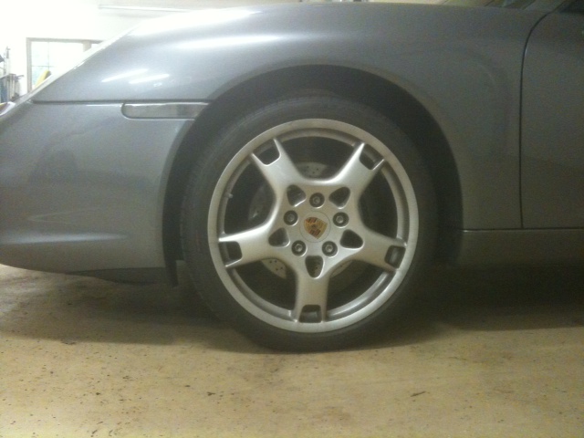

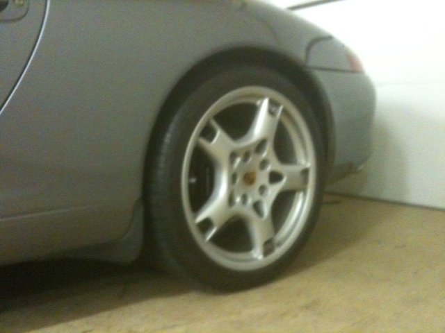

here are pics of the current ride height. front clearance is about 3 fingers and rear is about 2.

1. HD or sports....it doesn't matter....it's got NOTHING to do with ride height. Yes the sports are a little shorter (I believe an inch shorter compared to HD's)...and have a effect on dampening depending on what springs you're running. Regardless...has nothing to do with ride height...ride height is going to dependent on the springs.
H&R or eibach is your personal choice...i personally have H&R and sit about 30-35mm lower to the ground. It's firm but that's how I like it and it's not bad....you can keep the HD's and just swap out the springs of your choice.
2. 11 inch wide is not an issue. Many narrow body's run 11's without issues. It's mainly the offset and tire size. I'm not sure what offset your 11's have but in general, 60-63mm offset is fine. If you have 18's 295/30/18 is the general tire size. If you're on 19's from a 997, they run 30 series tires which make the overall tire size taller(since you mentioned 19's lobster claws). This may rub depending on the wheel offset also.

all---
Thanks for your insights. I'm running the 997 lobster claw 295/30/19 with a 67mm offset. Sounds like i can stick with the HD shocks and just add the lowering springs. If the Eibachs are a tad softer and I know they have 1/4 inch less lowering, that probably is the safe choice giving a little margin of error.
geetee-you mention the 997 running 30 profile tires on the 19s and that increasing the overall diameter of the wheel. This is exactly what I saw when I went from my stock Turbo Twists to these 'claws'. Wheel diameter increase by about 1/4 to 1/2 of an inch. When I replace the rubber, should I go to a different size on those rims?
