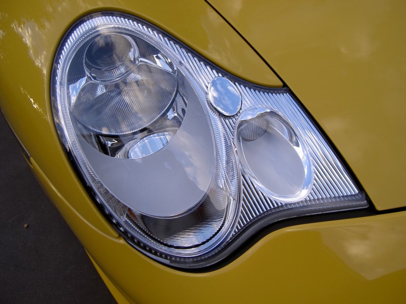

If the 04 996 has Xenons (Bi-Xenons on a 996) they should look like the pic attached - Note the Chrome shaped disc which is actually the head/cap of the washer arm. If this is not present, the car has standard headlights. Apart from this feature you cannot tell the Bi-Xenons apart from a standard headlight unless switched on!
Bi-Xenons are not exactly the same as litronics. Bi-Xenons utilise an extra H1 Globe for High-Beam when switched to High-Beam mode whereas the Litronics do not have this extra lit globe in combination with the Xenon lamp for High-Beam continuous use.

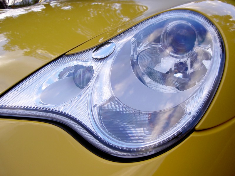

One more angle....
