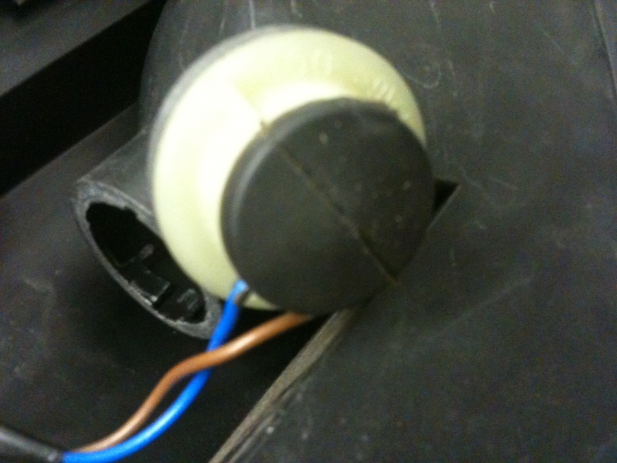

OK so I pulled the tail light out again. This time I pulled out all the metal tabs to make sure that they were making contact, notta . When I pushed on the back part (black rubber) of the light assemble the light turned on. When I released the black it turned off again. Is there a way that I can pull off the black part or do I just order a new assembly?
Here is the picture of the assemble.
Attachment 167933
Thanks
Copper
It's hard to tell for certain because the picture is blurry, but it looks like the black plastic part could be popped off to expose the leads for the wires. I do not know for sure. Never messed with that plug before.
There's only one way to find out...
