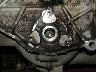

Inline with what rrrruben mentioned, I found this from the Flat 6 Innovations email newsletter (Jake Raby). I know the original post is looking at other cars, so I thought this may help"
"Featured Engine Failure
2006 replacement engine: Installed into a 2002 3.6 liter 996. This one lost an IMS Bearing and the owner did not shut the car down in time. The result was foreign object debris killing the cylinders. Note the IMS Bearing is the "new and improved bearing" as this same car featured a failed IMS Bearing with its original engine from 2002 and was replaced in 2006 with this engine. This car has experienced two IMS bearing failures in ten years! The engine was deemed a total loss after the cylinders were found heavily scored from foreign object debris contamination. This car could have been saved with by the IMS Guardian!"Name:  98.jpg
2006 replacement engine: Installed into a 2002 3.6 liter 996. This one lost an IMS Bearing and the owner did not shut the car down in time. The result was foreign object debris killing the cylinders. Note the IMS Bearing is the "new and improved bearing" as this same car featured a failed IMS Bearing with its original engine from 2002 and was replaced in 2006 with this engine. This car has experienced two IMS bearing failures in ten years! The engine was deemed a total loss after the cylinders were found heavily scored from foreign object debris contamination. This car could have been saved with by the IMS Guardian!"Attachment 170926
. From the research I did ( I also had a 1999 C2 for 7 years and drove it 78K miles without a hitch), if you have a car / engine that does not have to the problem in the first 30K miles or so, you most likely have an engine that will last. Having said that, it's more like the old saying " the two most important dates in owning a car is the day you buy and the day you sell it". So if you want to make sure you can get a reasonable amount of money back after you are "done" with the car.... the RMS / IMS / cylinder liners issues are going to put a major damper on the resale value and as long as you know that and are prepared and willing to part the car out instead of spending 12-15K on a rebuild. You are playing the game to win !!
