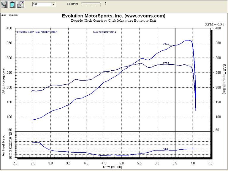

Video of My Dyno Run

The proper fuel maps need to be adjusted then the sensors will work how they are designed. Remember this is a street car so part throttle fuel maps also play a role as the wide open section where the dyno runs usually take place. The overall experience should be awesome power with a bit of extra fuel being used so the car still drives like a normal car. How inconvienient would it be to have to fill up every 150 miles just becuase a tuner put to much fuel into the part throttle mixtures. Just my 2 cents
We have done more than 1 of these supercharger conversions. We have also performed them on many other 1999 cars that are running fine. The rich condition here is most likely due to a boost leak, a bad MAF or a bad vacuum check valve. We do not tune like you mentioned above. The timing maps are very low to preserve the engine longevity. We have spent countless hours tuning part throttle so that these cars can operate like a normal car during day to day driving. Vince and I have been in contact and he is in the process of checking some things on the car.

It wasnt intended to rub you wrong however Vince has asked me to look at it more than once but I have been to busy. There are many things that can be wrong I agree. IS there a dyno run available for you to post that shows the correct airfuel ratios so everyone can see that Vinces car is just acting up and that your product is not the one causing the problems with incorrect fueling

Not rubbed wrong, just want to get the correct info out there. Vince was going to get his boost gauge hooked up so we can see what boost level it is running and at what RPM.

Good becuase I am now very interested in a proper air fuel run if you dont mind posting of course
SURE here you go JD

Still seems to dip into the high 10's oh well mid range still need some leaning up would help oh power as well especially in the mid range just a thought

Have you ever calibrated a Bosch ME5.2 ECU? If you have, have you ever tuned one for a forced induction set up? Becuse there is no boost sensor, you can never get them 100% perfect at all RPMS like you can with a turbo ME7.8 ECU.
