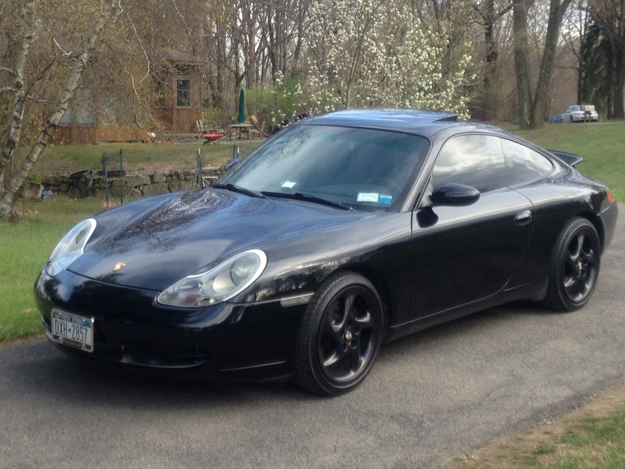

Attention anyone driving a narrow body 996 with 18" turbo twists with 265's rears
Get some spacers. I just put on 7mm/18mm and what a differnce in appearence. I only wish I did it sooner. What a great cheap mod.

Pics?

yes pics please i have this setup.

Yes, pics please. I have 18 turbo twists with 265 rears. I wanna see this mod.

I would love to post some pics but my iPad 2 won't let me. It won't let me choose a file to upload under the attachment option. To bad I just cleaned her up.

Here's a couple of pics of the car with the new spacers on.
