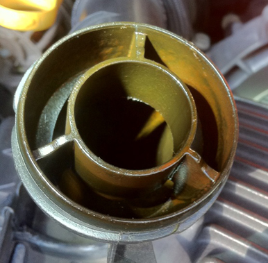

Oil or coolant residue?
does this look normal? just pulled the oil filler cap for the first time today just out of curiosity, but the 04 C4S used, 43K miles, 1 owner car. To me that looks like coolant res, oil dipstick and the coolant itself appears clean... any thoughts? thanks

My 2002 looks a hell of a lot worse. It's normal. It's water vapor that collects at the cap. Not to worry.

dont worry about... happen to cars that are not driven hard.
Mine has never looked like that
I'll beat on her some more then! Thanks!
Robert
+1....just check it once in awhile & wipe off the water vapor if there's any...no biggy
