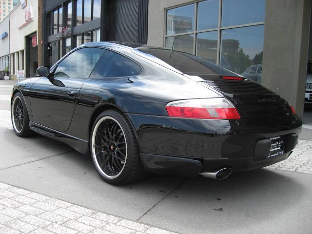

Here is mine with 295/30/19 rears
Reply
Sep 29, 2012 | 06:55 PM
thanks for the pic BUT my issue is the bang I get when hitting a bump at speed(50-60mph) Are you experiencing any? Did you anything to adjust height, camber etc
