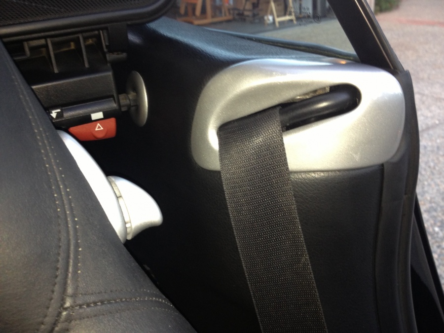

doing the center console, the seat levers & surrounds, covers where the front seat belts come out, and the clips where the wind guard attaches.
so far i have cleaned/sanded, applied adhesion promoter and primed (x4).
base coat and clear coat should be done by friday, back in the car mon/tuesday.
then i'll see how it looks and decide how far to go in phase 3 (eventually i will have a totally arctic silver car)
cheers, alan

OK - phase 2 is now installed. this was doing
- center console
- front seat tip levers and surrounds
- front seat belt surrounds
- wind deflector clip surrounds
obviously the center console is the big one here. completely changes the look of the car inside.

Interior is inished! Just counted up and I painted 49 pieces silver. Along with the leather, vinyl and carpet this looks like new on the inside. Only thing I broke was the adjuster for the passenger seat, so I need to get a new switch.
Now I'm just finishing up the outside; I have repainted the spoiler, touched up the scratches and cleaned/protected the roof. All I have left to do is something with the lights and maybe put a stripe on it.
It's looking pretty good for a neglected 2000 that's been out in the California sunshine most of its life.
