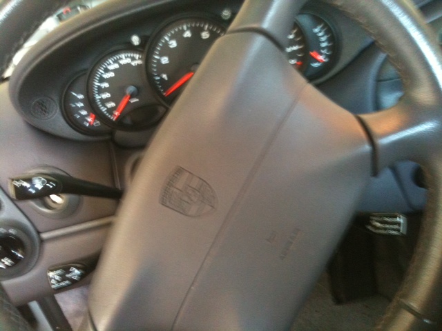

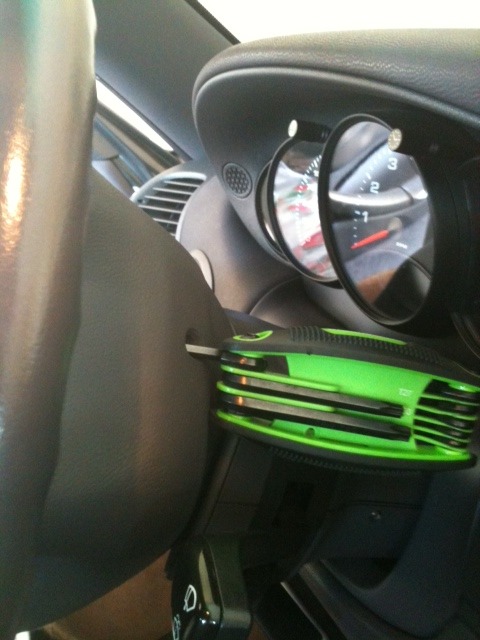

Step 1- turn the wheel about 45* from center so you can access the two airbag bolts, loosen the two bolts from the airbag with the T27 wrench:

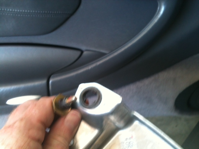

Step 3-unplug the horn ground connection at the 9'oclock position on the plate, remove the 4 19mm bolts.

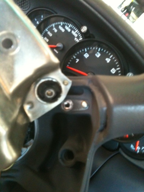

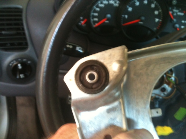

here you can see the failure item, the rubber bushings rot and prevent the trim plate from 'floating' and keeping the connections separated-

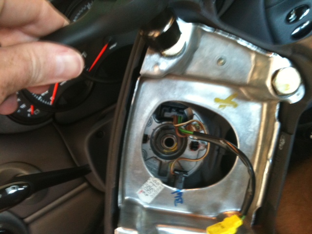

this is how the horn button connections look:
