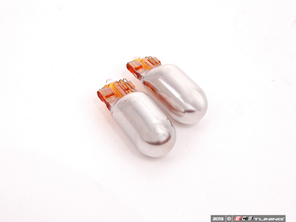

ECS Tuning - Porsche's Avatar
Joined: Mar 2012
Posts: 9,607
From: Wadsworth, OH
xman95 We offer the Chrome Side Marker Bulbs that offer the sleek stealth appearance that your looking for.
