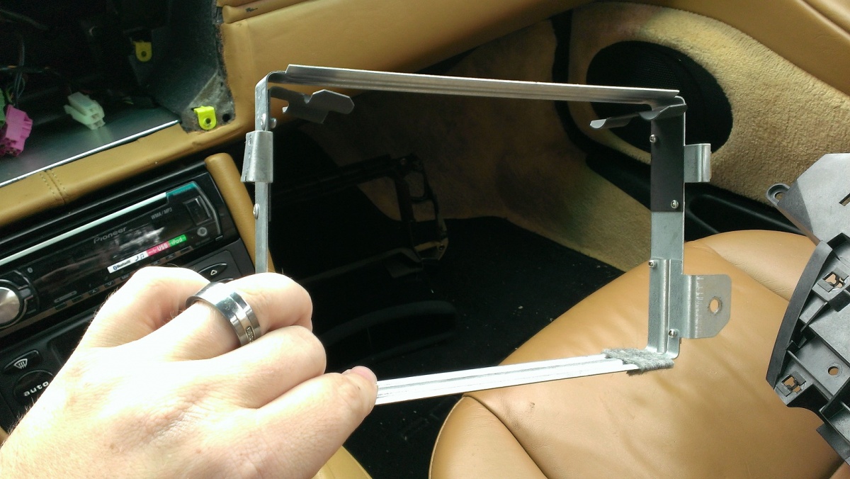

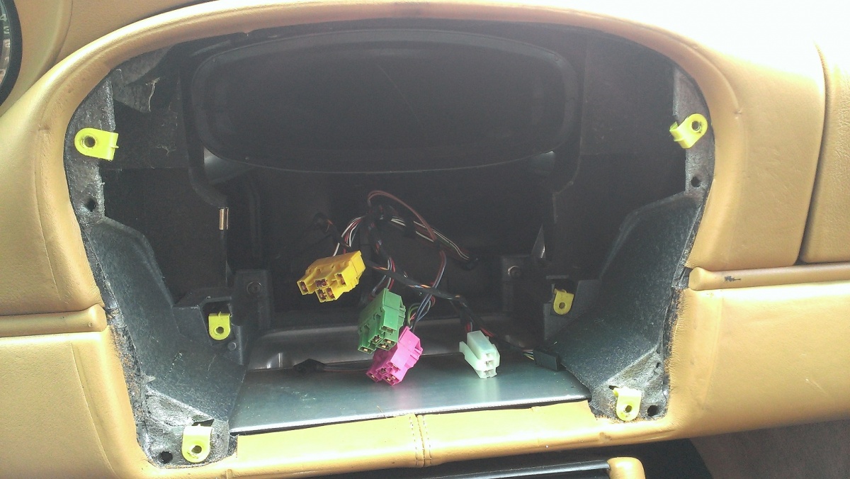

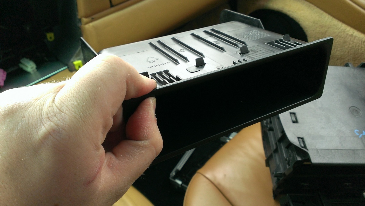

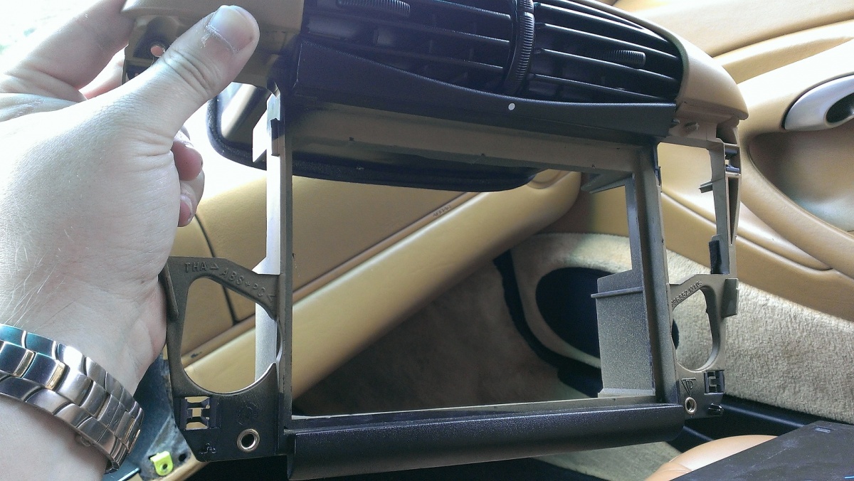

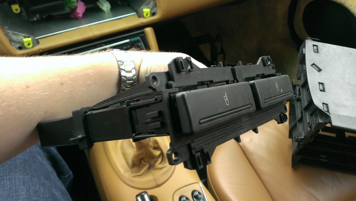

So I am having a major issue here. I ripped open my dash and none of the pieces match.
Supposedly the radio support I ordered fits 911 and boxster, but it doesn't fit at all.
Attached are some pictures and hopefully you'll get what I'm trying to do.
Please let me know if I'm missing any pieces or what I need to order.

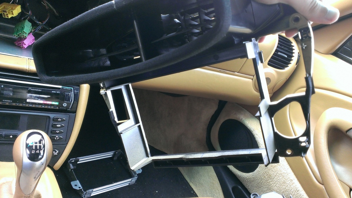

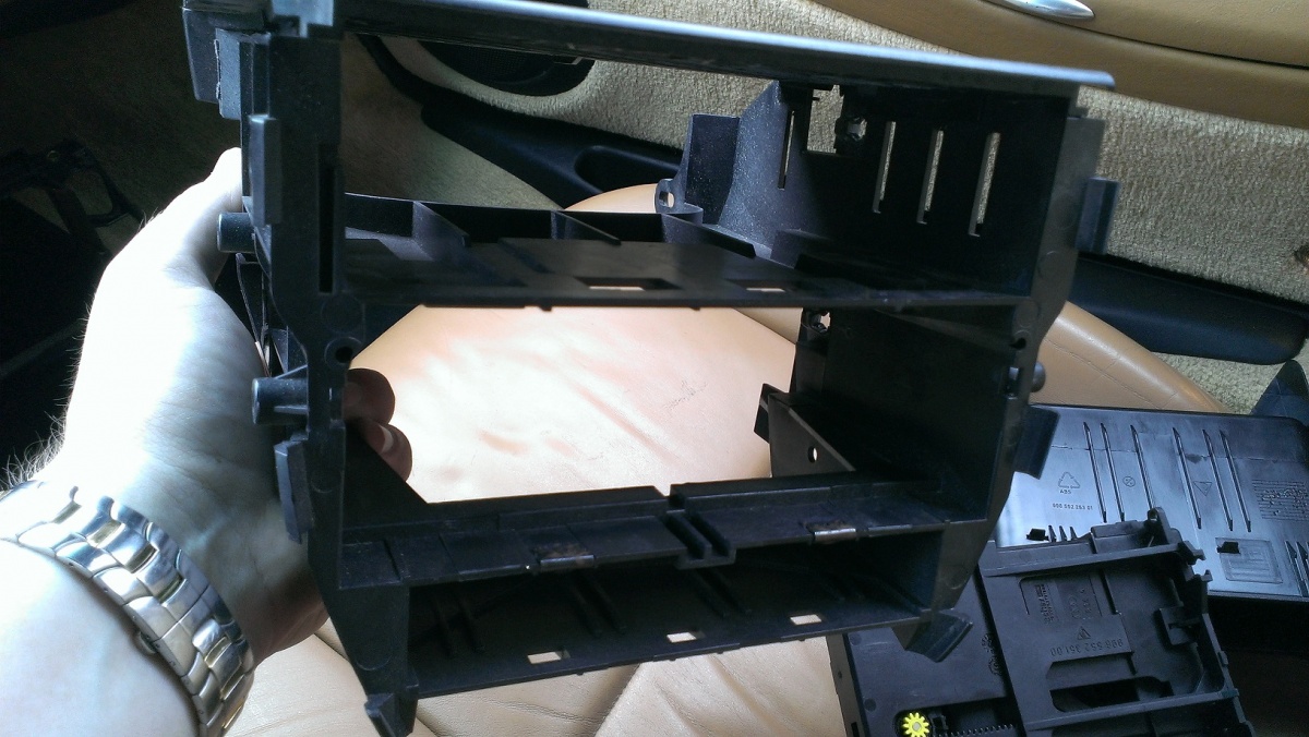

Some more pics. Only lets me upload 5 per post.

That's the support frame for a car with navigation. If you're wanting to fit that storage shelf, you need the correct retaining bar - 99655267302, and the correct support frame - 99655213104S33 (Savanna, non-leather, without navigation).
There's also an adapter for the cup holders - 99655259300. You'll need two of those
Retaining frame for the cup holders - 99655235100
Screw for the retaining frame - 90014307609 (4 needed)
Cup holder trim cover - 9965522870001C
Clip for the trim cover - 191853615A (4 needed)

Thank you for your very informative answer! Any recommendations on where I should order these parts?
Also, in the picture below - Am I needing part number 11?

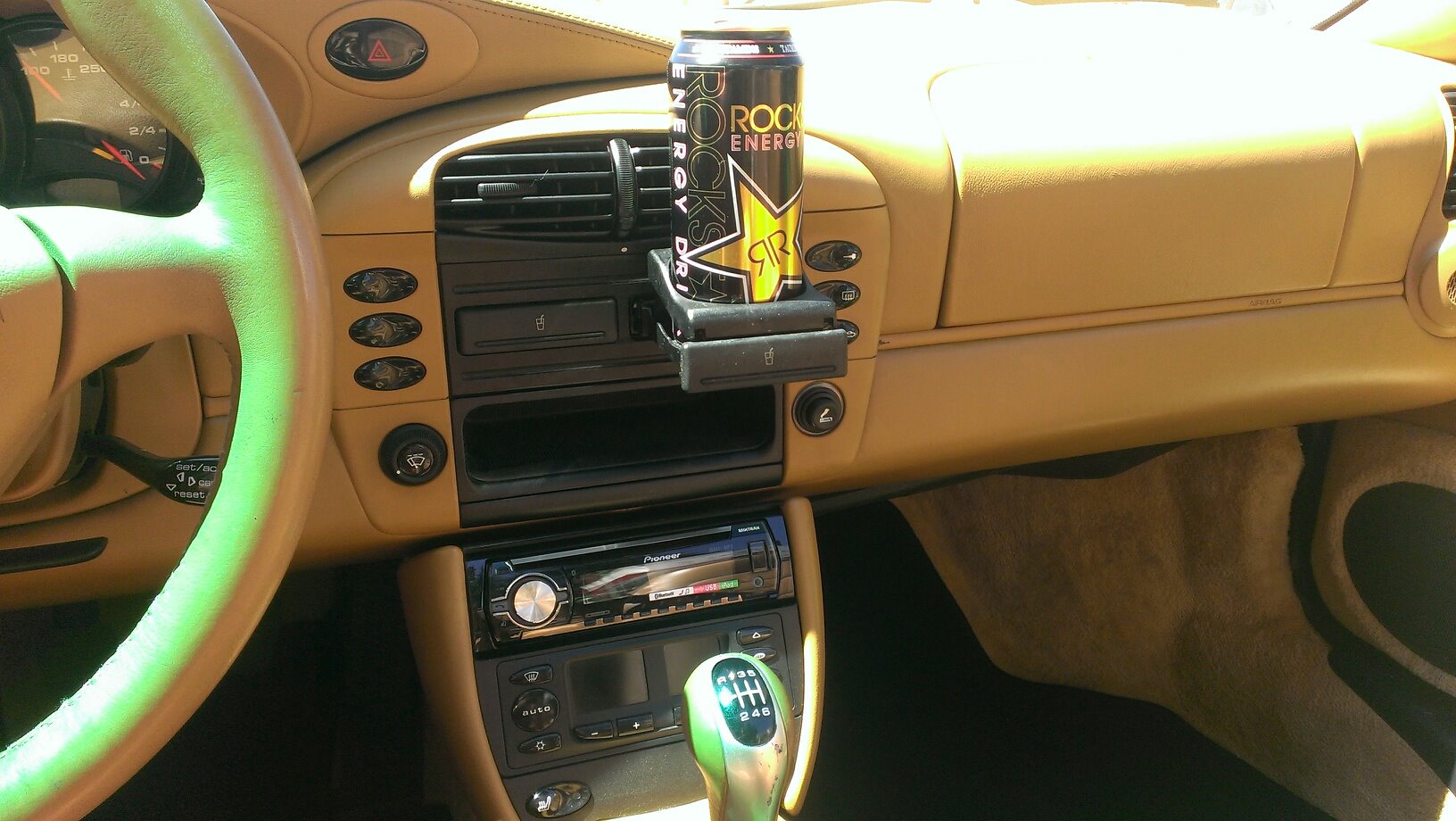

I figured it out and it works as intended!!! The exact setup I wanted!
Thanks guys!

Sweet! Looks perfect!

Glad you got it figured out, it turned out great
