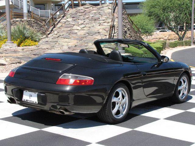

Recently, I just started to feel my clutch start to slip under moderate to heavy throttle in the higher rev ranges or upshifts under heavy load for a split second. I'm planning on replacing the clutch sometime in late October/early November when I winterize the car.
While I'm under there, pulling everything else out, what would you guys recommend that I replace or update, preventative maintenance included?
Just a little background about the car, it's an early 99 cab with 107K on the clock now. I bought it with 80K on the clock, a one owner in Phoenix. I bought it directly from Porsche of Scottsdale (he traded it in on a new one). Previous owner had the car serviced and only serviced at Scottsdale where the car was bought, yes the book is stamped and the dealer did the last major service when they took it in on trade at 80K. The clutch was quoted at being replaced at 48K for the major service.
I do not know about everything that Porsche does standard in their minor and major services. I'm just looking at putting a laundry list together of things that I could and or should do while I'm replacing the clutch myself.
Thanks!
Adam

Congrats on the new ride - she's lookin' good! From your description, it appears the service dept has been on top of the regular maintenance so there aren't a ton of items of concern.
