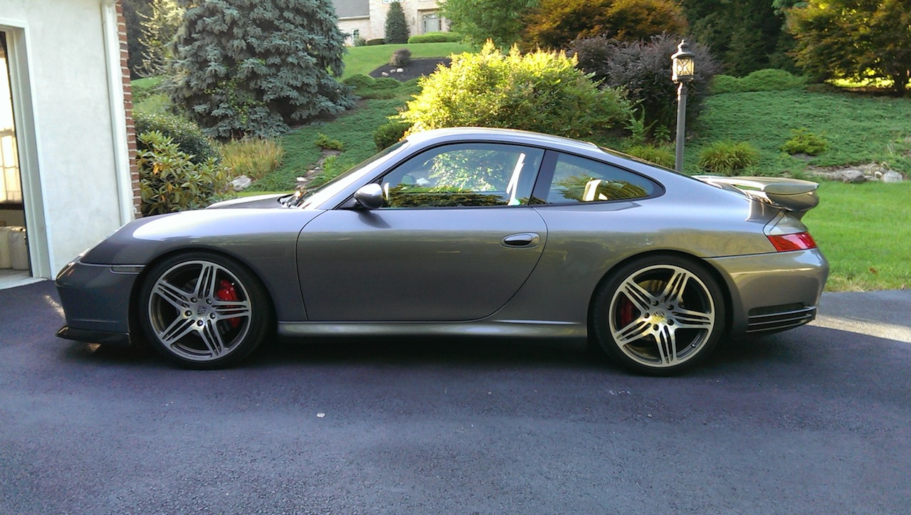

Like many others here, my car suffered from a sagging rear end. After I installed my H&R springs, the rear sat about 1/2 inch lower than the front and I couldn't stand it. I searched the various forums for a solution, and it appeared the only answer was "install coilovers".

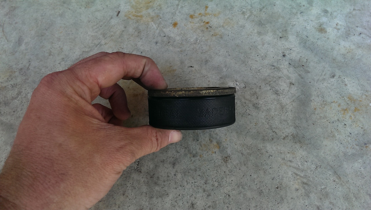

I wasn't satisfied with the consensus answer of "install coilovers" since I have no intentions of tracking the car and I didn't want to spend $3000. So as I was standing in my garage after my spring install, pondering this problem, I looked down and saw one of the hockey pucks I use as pads for my lift. Right then, a light went off! Hockey pucks are extremely dense rubber that hold up to quite a bit of abuse with little damage. I have used them for years on my lift and floor jack and other than a few scraps and scratches, they're all in perfect shape with no compression or deformation damage.

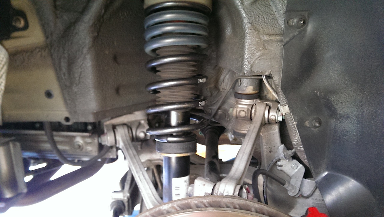

I took apart my rear suspension and compared the lower spring perch to the hockey puck… It's practically the same diameter!
So, I cut one to my desired thickness using a bandsaw and drilled out the center to the same inner diameter of the spring perch.
I reassembled everything with my new spacer in place.
And the final results are perfect!
I drove around with these in place for a couple days to let them settle in, then had my alignment done. So far after about a month of driving (1,200 miles), they are still perfect. The car drives and handles great. I took them apart again to examine, and other than a very small amount of compression (maybe 1-1.5mm), there are no signs of deformation or splitting.
I'm curious what everyone thinks, is it mad genius or blasphemy!

Did you consider an additional spring perch for the top side where the spring makes contact?
I did consider this and even called my local dealership's parts counter about it. They couldn't find a part number for just the spring perch and told me you had to buy the whole shock.
I think a metal ring on top of the spacer would be the perfect setup to prevent wear and tear on the spacer.
