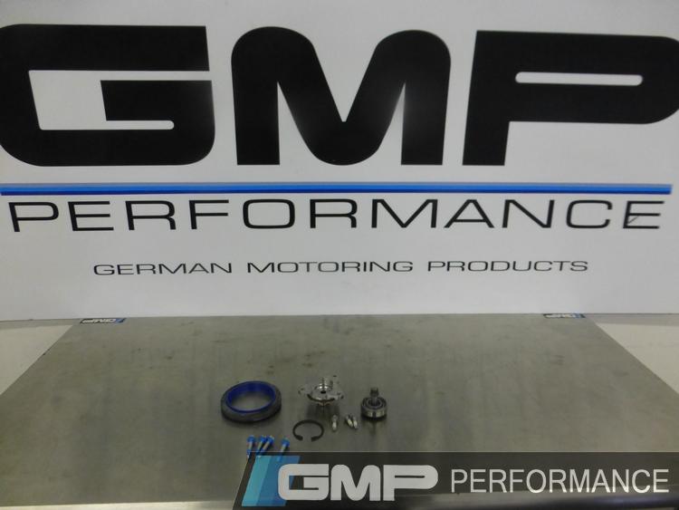

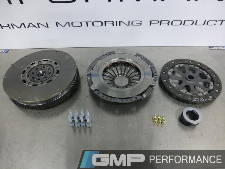

Parts Installed:
Porsche Boxster and 911 models LN Engineering IMS Retrofit -Single Row

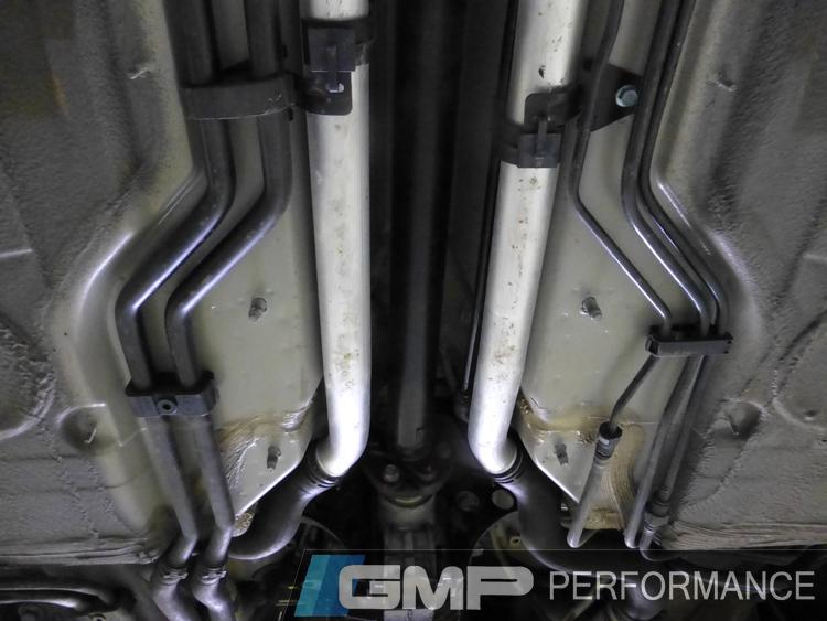

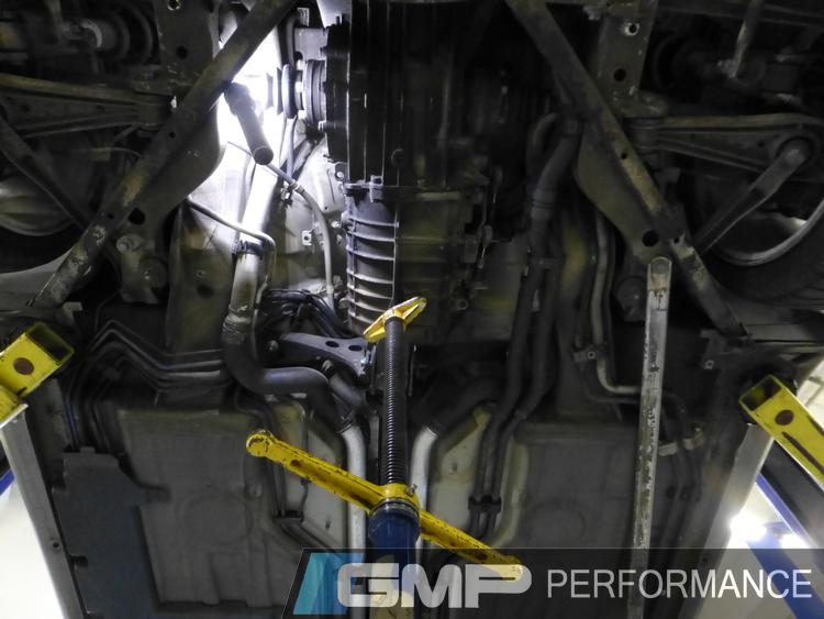

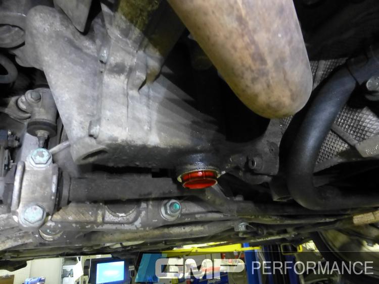

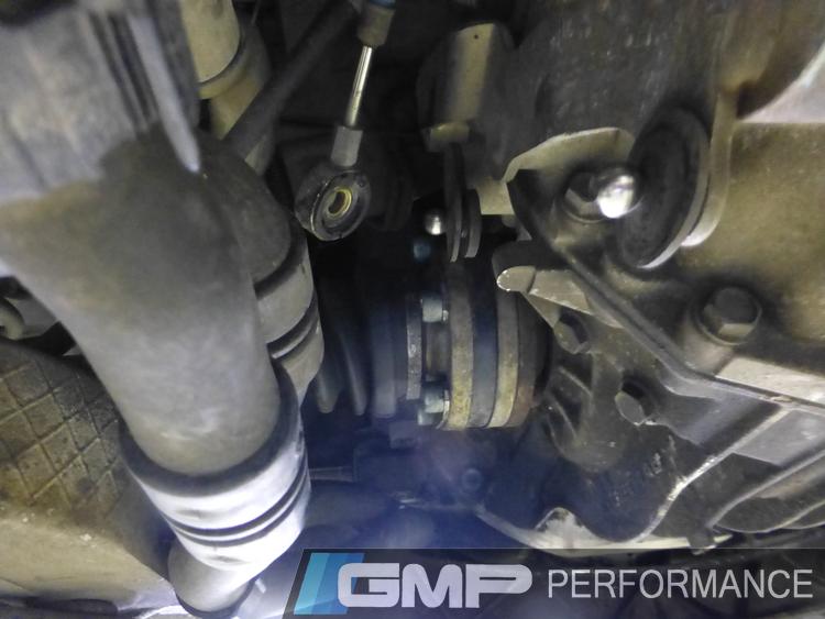

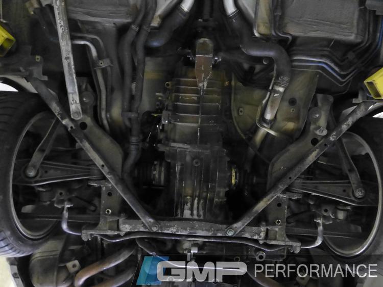

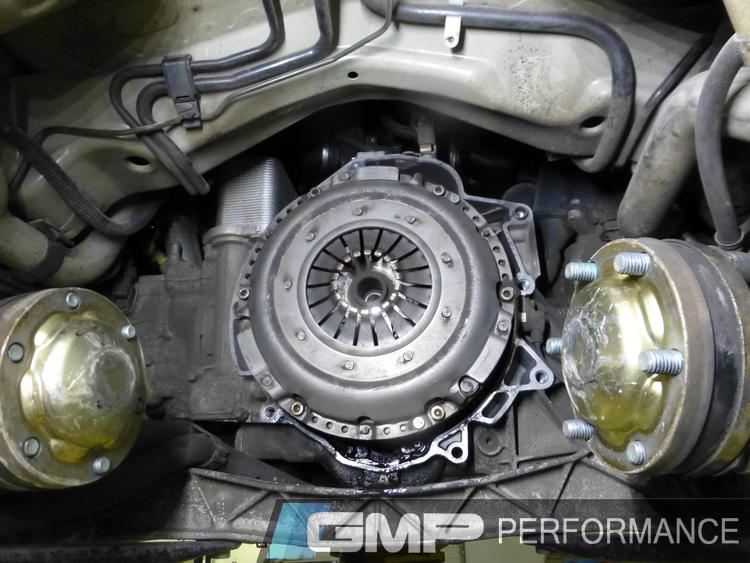

Under body panels and trans mount removed

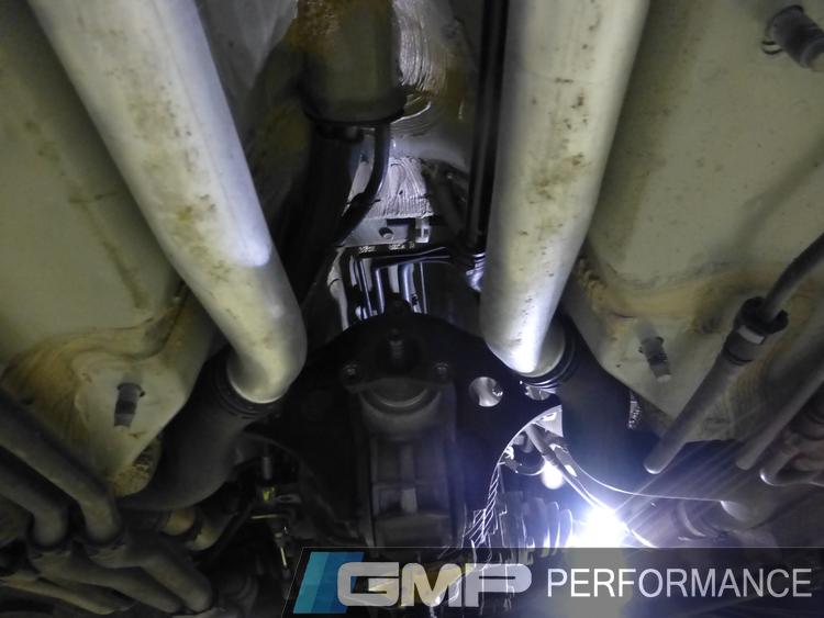

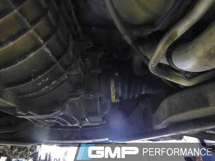

Drive shaft removed

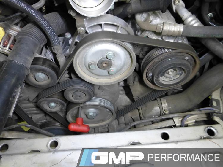

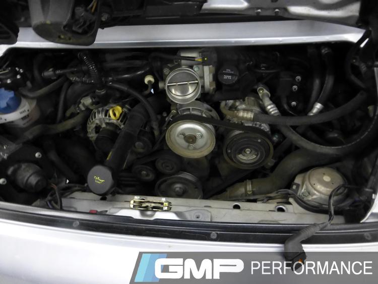

Air box removed
Crankshaft locked into place

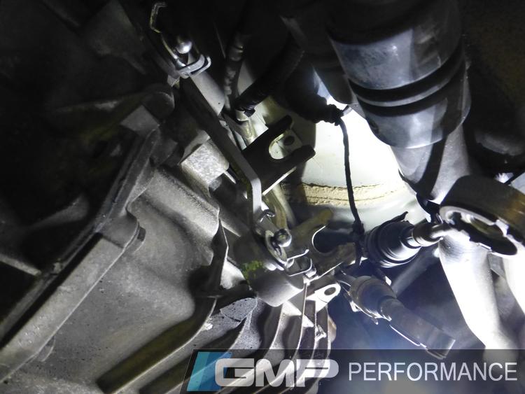

Shifter linkage disconnected

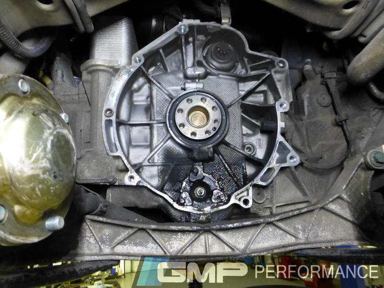

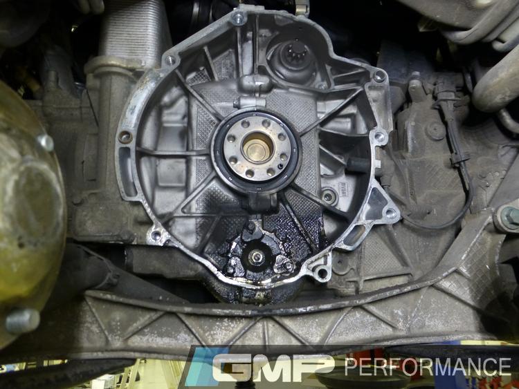

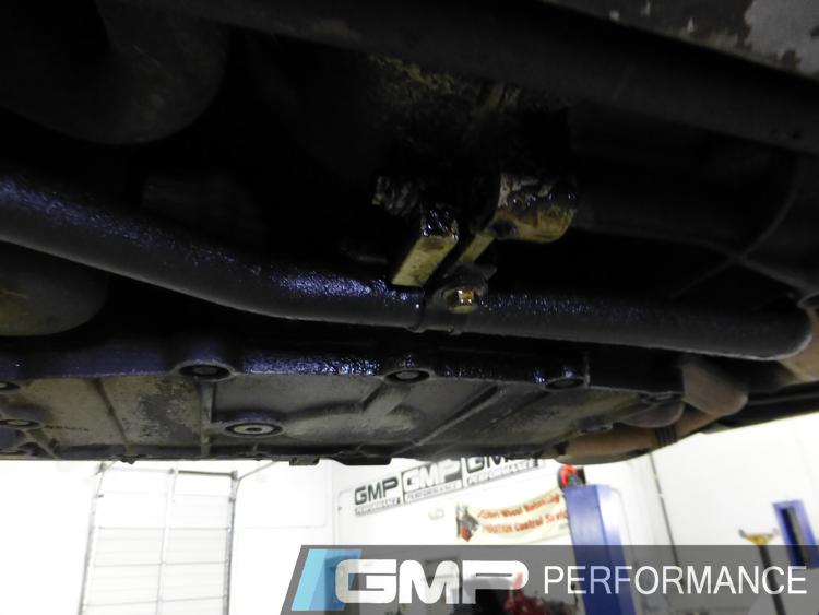

Oil leak from bell housing
Transmission removed

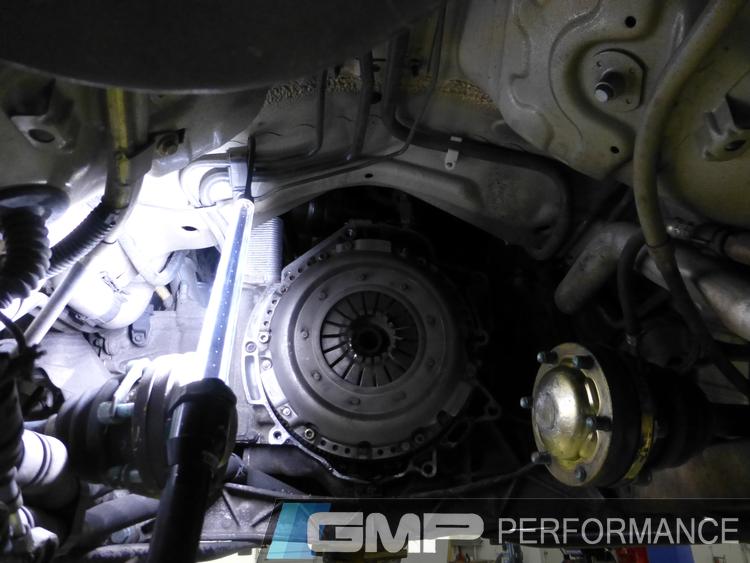

Transmission removed exposing clutch pressure plate

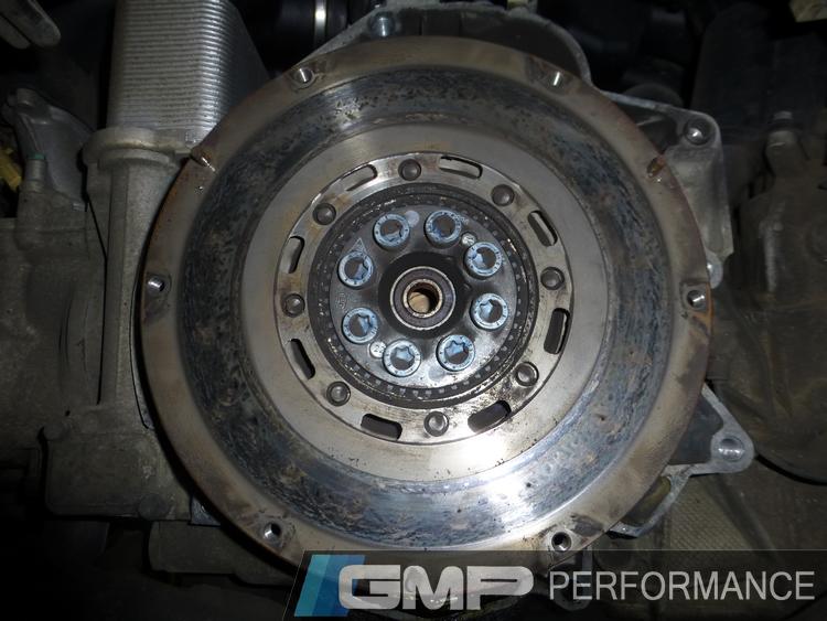

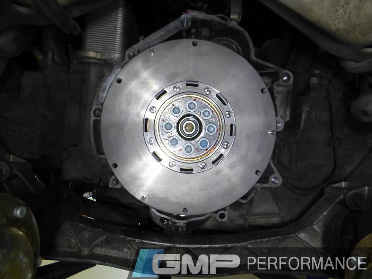

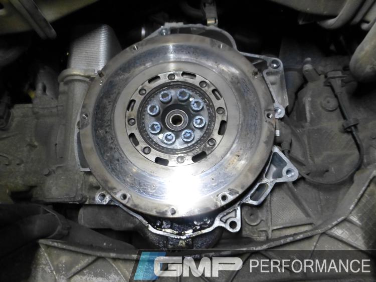

Clutch disk and pressure plate removed exposing flywheel
Old worn out flywheel

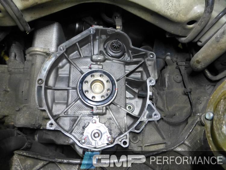

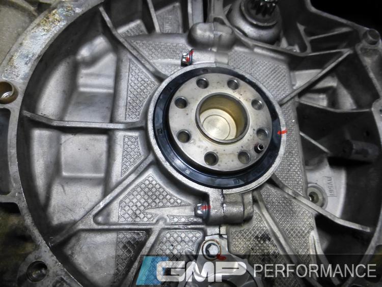

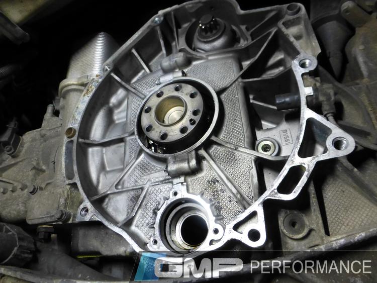

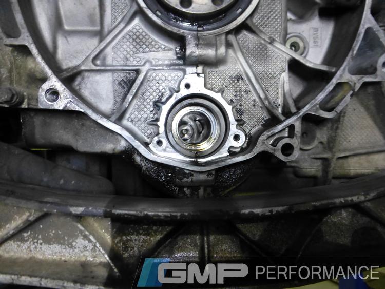

Flywheel removed exposing IMS bearing and rear main seal

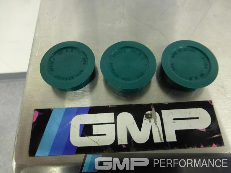

Camshafts locked into place

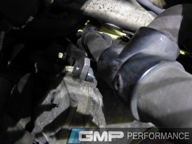

Timing chain tensioner removed and hole plugged

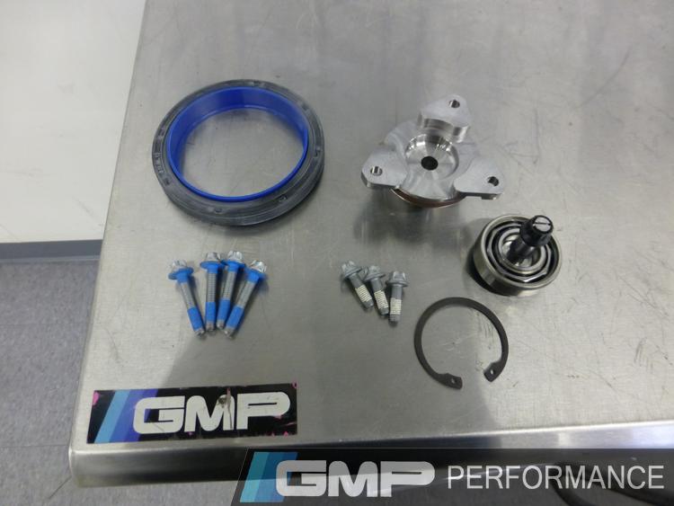

New IMS bearing, main seal, and engine case bolts
New cam cap seals
Old bearing
IMS Bearing removed
Rear main seal removed
Rear main seal and engine case bolts installed
IMS Bearing installed

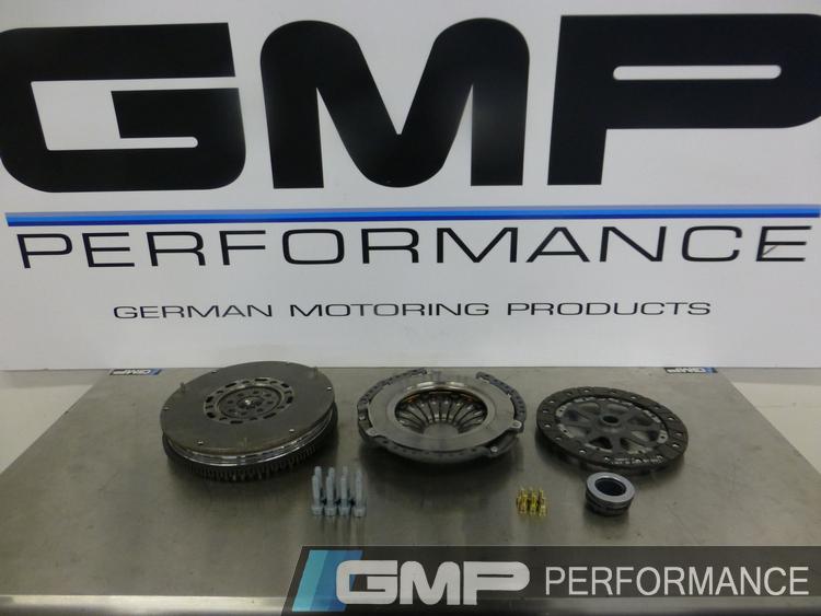

New flywheel and clutch kit
New flywheel installed

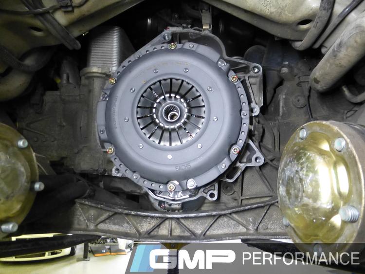

New clutch disk and pressure plate installed

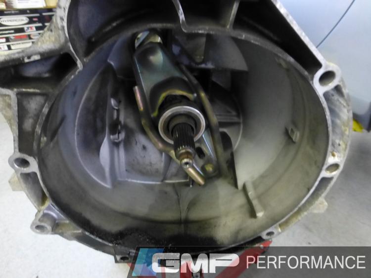

Transmission bell housing

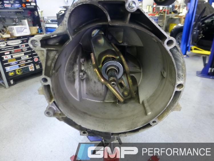

Transmission bell housing cleaned out
Transmission reinstalled
Drive shaft reinstalled
C/V shafts reinstalled
