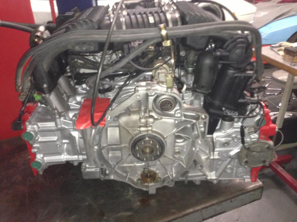

Hello guys, I need some help with some numbers and how to achieve them. I'll do a proper write up on this engine build when I'm done. I'm 90% there. I have a m96 type engine (1999) enlarged from a 3.4 to a 3.6. I have the VF Engineering supercharger kit. Engine has been rebuilt with the weak components replaced. Stock compression with a 2.62" pulley would give me around 575hp at 18psi (a best guess on my part, I may be off, that's why I'm asking for advice). The problem I have, is I want 21psi, and I have changed my compression to 8.5 to 1. Stacey, if you read this, I'd love your input. It's been a long while since I've been on the forum. Almost forgot, heads are stock.

Thanks for the interest guys! I'm going to be very vague until it starts and runs, maybe even a text run down the 1/4 mile. The only reason I am using a supercharger is becuase your correct, (I'm in it too ***** deep at this point lol) Even modifying the body to make it more desirable was a hassle. But Bow didn't let me down, and gave me the finished product, in steel I desired. I would love a TPC kit, maybe later.
