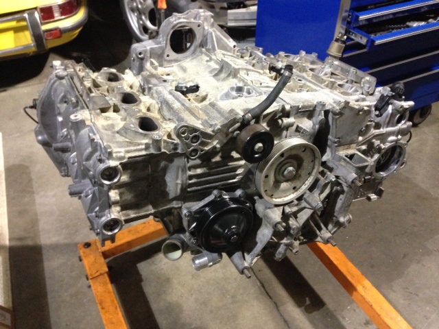

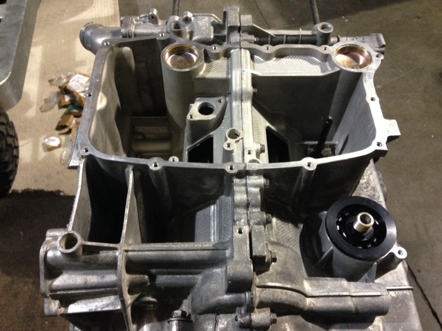

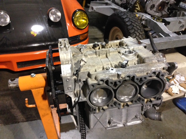

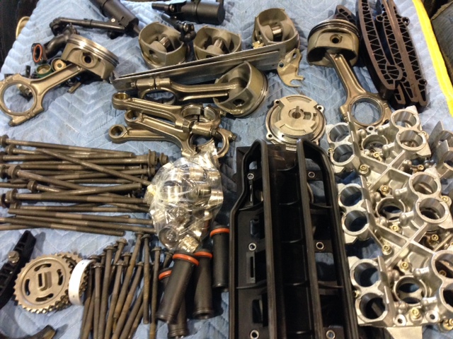

Well car is back together. He is going to drive it for a few days and put some miles on it to check everything.
Can't wait. Final reports was engine was in great shape and initially did not see any metal in the oil (I changed it before sending it out). But he found a lot of shavings in the IMS when he was taking everything apart. The IMS bearing (that was placed 4,000 miles ago) was in good shape but I had him put a new on in anyway. Went with another LN bearing.
and the damage
and some pics
