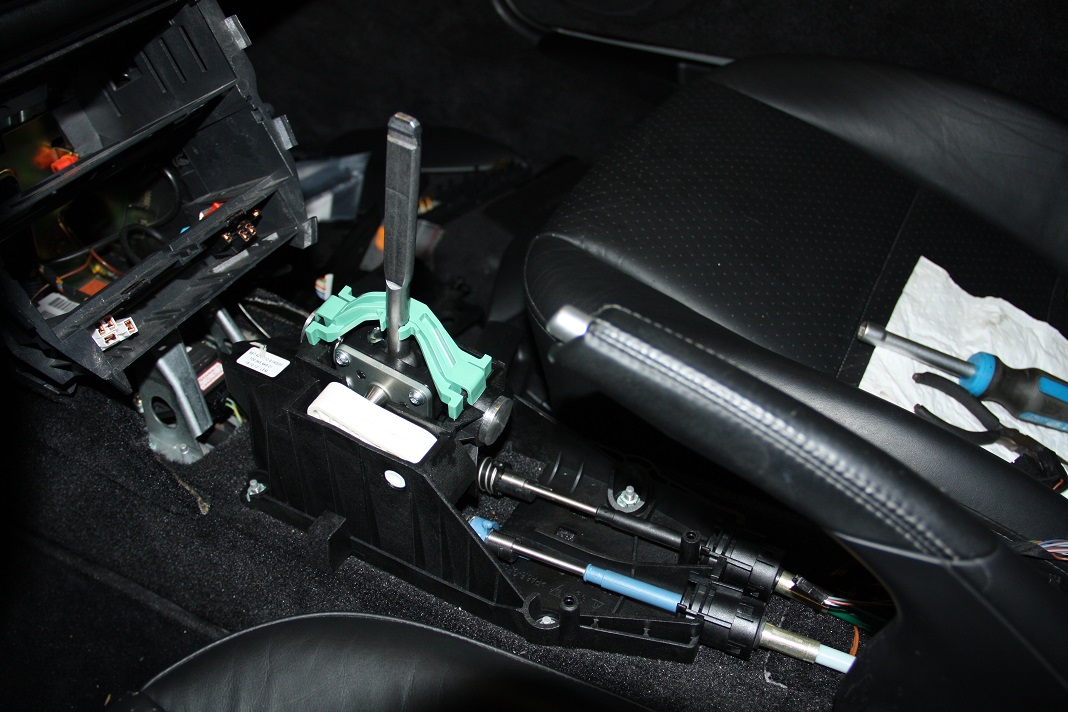

The GT3 is a bit shorter than the normal i think, I would go for the 997 GT3.
Have that in my car, and just love the feeling!
And as an awnser to your question, yes it was no problem att all with the fitting
