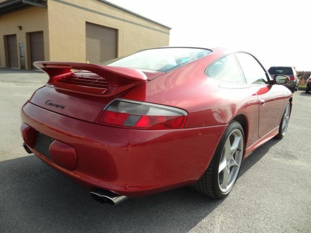

996 MKII, Aero rear Wing could have been 2 different styles in 2003 & 2004.
The shape of the Wing looks right, but, I thought both styles came with relocated third brake light.
Here is a picture of mine, on my car it was referred to as Carrera Aero, my Wing was offered on both Coupe and cabriolet.
The Wing you have would only be offered on a coupe.

That sticker is actually from the wiring harness not the deck lid. 996 620 71 50 is the harness only.
The wing is an aftermarket one all aero kits have the part number stamped. They OEM ones are made in Switzerland.
Another way to tell is the holes where the wing is attached on either side. The OEM wing has a rounded rectangular cap whereas the aftermarket usually have 2 vertical holes.
Doesn't make it any less valuable as it still fits all C2s. I just wouldn't advertise it as a genuine one.

There is a GT3 Wing for sale on eBay, it is stamped made in Switzerland, that was a surprise
QUOTE=dan_189;4391495][/QUOTE]
Interesting that your wing has that sticker. I was under the impression that all aero kit ii wings were stamped on the underside with the part number.
Another way to tell is the holes where the wing is attached on either side. The OEM wing has a rounded rectangular cap whereas the aftermarket usually have 2 vertical holes. That's just what I have seen.[/QUOTE]
