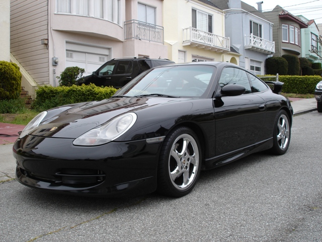

Hello to all my fellow 6speeders. I'm new to this site and a new porsche owner as well. I was wonding if I can ask some of you guys for your opinion. I'm looking to upgrade my exhaust and intake systems on my 99' C2 that I just bought. I've been reading some of the posts and I see a lot of ppl talking about fabspeed, PSE (porsche sports exhaust? i think), techart, RUF. What's the performance like on the PSE? I have an oppertunity to get for $1000. Some ppl have told me that it doesn't add any HP and others told me it does. I'm looking for an exhaust system that has good performance and still sounds like a porsche. I live in san francisco, CA so it has to be smog friendly.
I also wanted to know if I get a full exhaust system (headers, sports cats, mufflers) with intake, will I need to upgrade my computer as well or can I leave it stock.

Changing your exhaust system does nto require a new ecu but it would help to get teh most out of it. Great looking 996 by the way! Welcome to 6speed!!!!

Thanks for you advice andy. But what is I/H/E and DME flash? I'm thinking it's some kind of computer mod? I'll PM you when I think my car is ready to come to santana row. There is something wrong with the site. It won't let me upload pics. I have a pic on my original post, but I'll post more when it lets.
