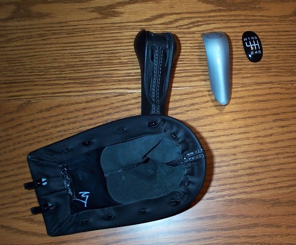

5. After disassembly you should have three pieces:
Leather covered shift **** and boot
Silver painted plastic piece
Oval 6-speed shift diagram

Here's a picture of the disassembled pieces of the 996 shifter.
