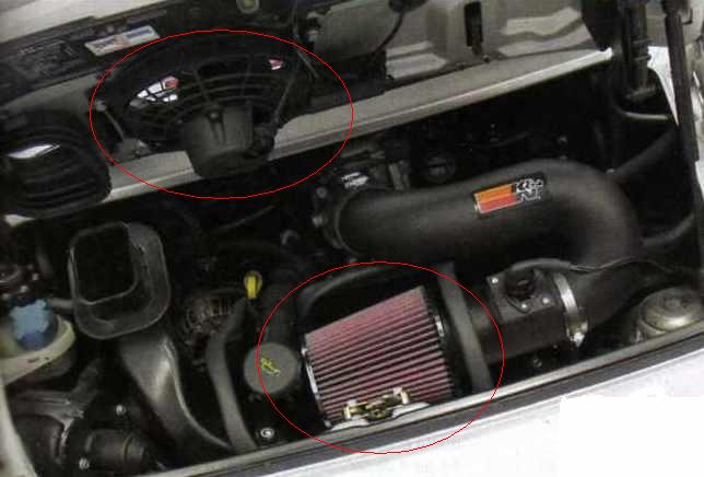

Abdullah:
The performance is about the same. Unfortunately, the K&N kit is a bunch of parts made for a backyard mechanic and the design mounts the air filter under the fan (the only place where water can fall directly onto it). Problems include rubbing during acceleration, MAF sensor damage and moisture related engine damage. Also, K&N voids the warranty if you don't use the water shield, which is not used during performance testing.

Do Cold Air Intakes alone do anything?
Listmates,
My only experience is with my 00 Boxster S. I added a cold air Intake, and while sound was more fun, and i thought the car was a bit peppier on the low end, I researched and concluded that the ECM adjusted for more air so that Net net I got nothing! Is it different with the 996? Specifically, my 03, since i am asking

Been looking up info on the K&N and about a year ago there were problems with the oil going through the intake and ruining the MAF, did they cure this problem?
I used an AEM Dryfilter part number AEM 21-2059DK to prevent oil spoiling the MAF. Been running 1 year with issues.....knock knock.

Looking at the K&N set up, it looks to be positioned right under the engine lid fan. I have heard that this unit just sucks up hot air from the engine compartment (thus hurting HP) and that dynos aren't really giving a true indication of what the K&N is doing to increase power because there may or may not be a fan blowing on the engine. In normal operation when the engine fan is on, wouldn't the K&N be receiving cool air from the outside forced on to it? Isn't that a good thing? Also, I also have read that there is a mod to turn that fan on manually (w/o affecting the automatic function) to help cool down the engine when it's being run hard. Wouldn't this be a no brainer mod to go along with the K&N? MAF issues aside (and I've read the EVO units aren't always immune to this), wouldn't this be a an design advantage over the evo unit when used on a clear on sunny day? Also, I have read that there is a rain shield but I don't think I've ever seen it. Does anyone have a pic of how K&N unit looks with it on? BTW...I don't have a CAI but I've toyed with the idea of getting one. I actually have a flat K&N filter new and in the box but as with the cone filter, the MAF issue does concern me along with the fact that the K&N flows more air thus could let more pollutants into the engine. Just using the regular air filter at this point. Curious to see what others have to say.
