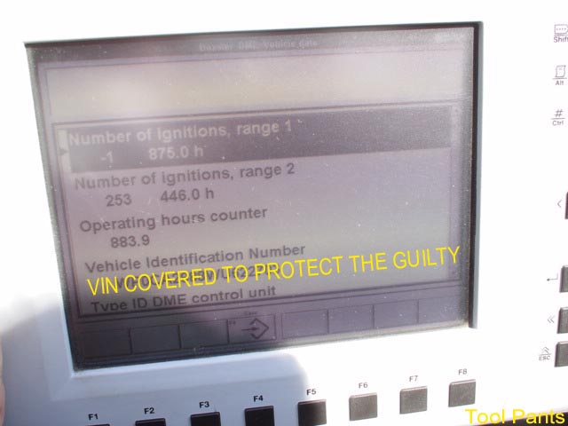

Originally Posted by oak
if you have any stage 2 over revs you can count on your dealership to give no consideration if you have any mechanical problems with your motor.
This is probably an exaggeration. The 997 DME record over-revs differently than the 996. They are recorded as range 1 through range 6...no longer stage 1 versus stage 2.
When you over-rev from 6th to say 4th, the DME will record the number of ignitions the car spent at each stage. It will also record the time at which the last event occurred. Stephen or some other expert can probably correct me, but I'm pretty sure there are 350 ignitions per second. So PIWIS should show you the 350 X number of seconds the car spent at each range.
Most dealers will forgive a few brief over-revs for range 1 or 2. Excess or higher range over-revs indicate abuse.
