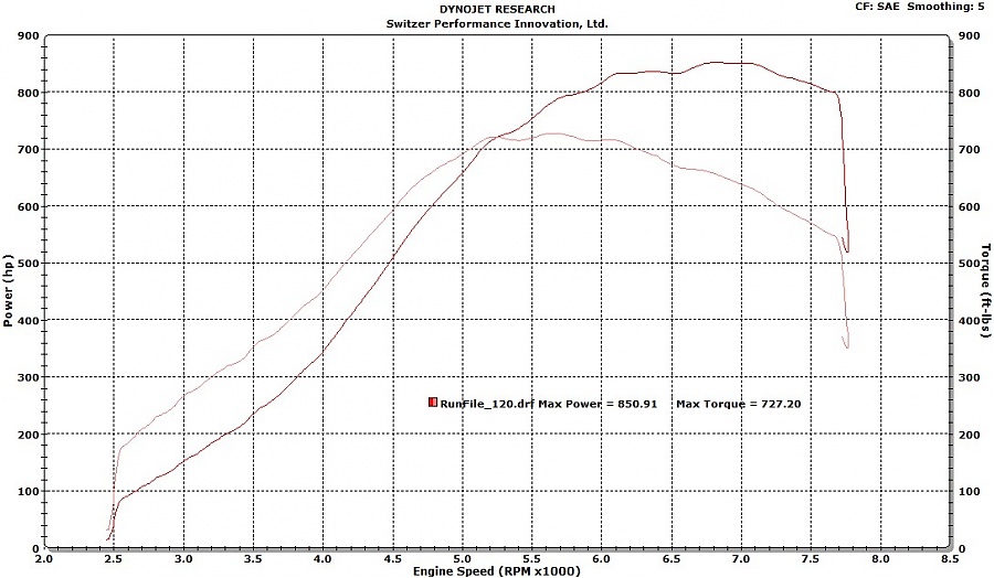

Update...
Hello all... it's been awhile since I've had a chance to post. As many of you know, we've been very busy with a lot of R&D and testing.
If you've been following along, David's car has been an ongoing project for us. I really want to take a second and publicly thank him for giving me the latitude to develop the parts necessary to meet his goals for the project. He's been very patient with the process and I can't thank him enough for that. While I'm at it... David has been a great customer for me over the last few years... one in a million. Just to make it clear after reading through some of the previous posts today... David is not a partner nor does he have a financial stake in what we're doing. We're turning every dollar we make back into the R&D and manufacturing of our components. We work hard and pour ourselves into what we do. It's that simple.
Moving onto the car... we had so many people asking us about the car when they would come in... how much power does it make?... how fast is it?..etc... we jokingly just started calling it the "Sledgehammer". We figured that made a point about what the car is about.
Again... if you've followed along, you know that we started out with twin 30's on the car... actually, we have tested half a dozen turbos on the car... ending with 35R's. For the parameters of this particular build... stock engine w/stock cams and nothing other than bolt ons... the 35's were just too flat for my liking and the 30's just weren't cutting it out of the box. So after putting together all of that data, I decided to put together a custom turbo that I felt would give us the best of both worlds and optimize a 7500 rev limit for this package. In doing so, we've got the response we were looking for along with the top end performance to meet David's goals for the car. I went ahead and wound the car up a bit on racegas with the new turbos... they hit a lot harder than the 35's and deliver up top within the constraints we've put on the build. 1.65 bar peak boost on the logs... made 850rwhp/727rwtq on our dynojet. I'm keeping the tune on the conservative side due to the stock internals and the fact that it's been in the 90's here the last few days. The engine is sucking in some pretty hot crappy air! Since our goal is 750whp on pumpgas, I feel that we can achieve that with these new turbos and the data I've gathered so far. That tuning comes next.
I've attached a copy of the dyno sheet from today with the new turbos for anyone who's keeping up with this project.

I don't understand how this stock engine is holding up to that kind of power and torque, even with race gas and proper tuning. It goes against what is known historically. Kudos. Simply amazing.
