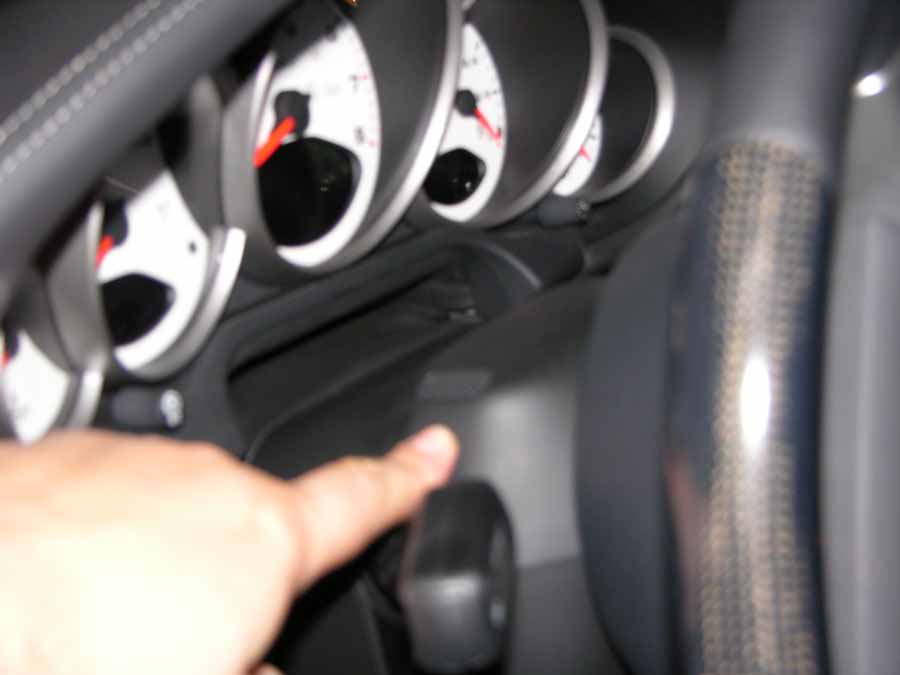

I had the BTA1500 installed last week in an 07 997TT that has the Gateway 500. After some trial and error we decided to install the Dension Mic where the OEM mic resides on the steering column. I haven’t tested the unit to much seeing its over 100 degree's here this week. I strongly suggest you and your installer test a few places in the car to hard wire the mic, as we found there were some echoing on the 'other' persons phone when they spoke the closer the mic was to the speakers. The sound was great inside the car and once I set my phone to have the bluetooth paring on 100% of the time, the phone and the car automatically pare nicely.

The software integration is a bit different then the Porsche OEM phone (my other car has that) but the unit works fine once I got use to the differences. I'm sure Dension will tweak and upgrade the software as they have done with the Gateway 500.
<O</OOn a side note, I asked my installer to try to hook up the OEM mic in the steering column (even tho I did not order the phone module the OEM mic was there) and after some McGivering we tested the OEM mic with the BTA1500. We found the OEM mic to be at 15 ohms (think its ohms) and the Dension mic to be 10 ohms. The OEM mic was louder and clearer but unfortunately every word spoken from the 'other' persons phone had an echo so we went with the Dension Mic.

Hey Stubbie,
I have suffered from the echo problem you are referring to and have never found a mic location that solves the issue. Can you post pics and a description of exactly where you placed the mic to eliminate the echo?
Thanks!

Both the OEM Mic and the Dension Mic are under the cover. He placed the Mic under the slots.
On some calls the Mic volume is to low, when we tested it, it was ok. Now I'm unsure if this is gonna be the right spot.... grrr

haha, sorry Subbie... that was an innocent typo for a firstimer. Some have said that all who drive fast sports cars might have a stubbie.. Good thing its not true (achem)
Everywhere I move the mic, the other party either hears an echo or can't hear me well. I can hear them fine, but haven't been able to solve the mic placement issue. I wonder if a higher quality mic would work than the one they provide.
On the otherhand, maybe its an issue with our type of phone and not the BTA. I have a blackberry, what do you have?
Does anyone else have experience solving this issue? With the CA handsfree law, this became a higher priority for me now.

As I mentioned, we tryed the OEM mic in the same position, sounded great but was worst on the echo bit. I'm hoping this is an issue that Eric and Dension can work out with a software patch.
I have a Motorola Razor as the host phone.
Btw, you can turn the stereo volume way down and that will help with the echo a tad. Of coure you will go deaf trying to hear the other person.
Help us Eric
In a perfect world, have Dension make a connector that works with the OEM Mic and then fix whatever is making the echo so bad. The OEM mic sounded really good.
