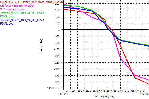

Yes and no. I use the height adjustment of the coilovers to get the desired ride height. Then I use the alignment adjustments in combination with the endlinks to achieve corner balancing. I want as little spring preload as possible in order to have as much suspension travel as I can. In my case it is roughly 3.75 - 4" total suspension travel. This makes it work very well over bumps, and at the ride rate I am running occupies the lower end of track performance. I daily drive mine on bad roads so I had to be selective about how I wanted things setup. In order for me to improve the setup for the track I would need functional aero and then maybe 10% more high speed damping. As it is I am running at 0.5 inches per second I am at 80% of critical and at 3ips I am at about 55% critical, my shock forces continue to taper and then blow off pretty flat after 6ips.
I decided to share a shock dyno for my fronts. The blue line is the final, the others are labeled for what they are. Factory NON- PASM, H&R off the shelf, and then the revisions to final for my fronts.

Thanks for sharing. Interesting (but I must say IMHO, very strange) approach to corner balancing and using sway bar.
How did you test the alteration from H&R off-shelf to your revision? By improvement in time trials at the track?

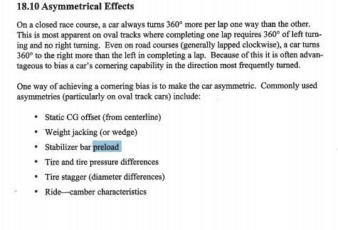

It is not strange at all. It is novel to you. Here is a blurb from Milliken and Milliken Race Car Vehicle Dynamics
I have done AutoX with the stock PASM shocks with lowering springs (previous owner mod). Then with my custom coilovers, my AutoX times went down by about 3 seconds.
Here are additional references to suspension preload:
Spring preload:
All about sway bars:
Sway bar Preload tuning:
https://www.joesracing.com/setting-the-bar/
"Whether you use a standard one-piece bar or a three-piece big bar, your sway bar will work more efficiently if you mount the link that connects to the lower control arm at 90 degrees.
Upon arrival at the track and with your car race ready it really pays to set up your scales on the most level ground you can find. Shim the scale pads if needed and mark the pad location so that you can weigh the car at the track in the same spot. Once the scales are set up, weigh the car and record any difference that might be created due the track ground not being level as compared to your shop set up. By establishing a baseline at the track, you will be able to make adjustments and use your baseline to maintain proper loading of the bar, ride heights and wedge. An established baseline will help to get you back to your desired numbers even after many trackside changes. Check the sway bar at the track, with the car on the scales, and note any difference in preload as compared to when you set the bar in the shop."
https://www.hotrod.com/articles/ctrp...-spring-setup/
"Sway Bar Preload
One benefit of using a sway bar is that it helps us get more bite off the corners. Sway bar preload, actually pre-twisting the bar, increases this bite effect. It also causes an increase in the crossweight percentage. It is best to put in preload and then set the correct crossweight in the car. That is opposite the way teams have usually done their sway bar preload, but we need to know exactly how much crossweight is in the car when we race it. If we set the crossweight and then preload the bar, we don’t know where our crossweight is."

Thanks for taking time to explain - nice work. How about between H&R stock and H&R modified? Huge improvement also?
Miliken seems to mention in "Asymmetrical Effects" stabilizer preloading one side of the car is advantageous in closed race course's environment, where you turn only one way (left or right). Does this mean this approach does not work for a street driven car, or at AutoX?
They mention road courses too, in the same paragraph. I simply included it as a for example sake for racers using sway bar preload to tune cross weight load transfer // corner balancing // making corrections to a steering behavior.
I did not test the H&R stock because in my opinion it has too much total damping making it stiff, jarring, or harsh. I have had similar setups on other vehicles I have owned. The graph I supplied a few posts ago show the stock H&R on a shock dyno and you can see it has a very large amount of rebound. Because my car is not aero dominant there is no need to pull the chassis into the bump stops and hold it there. I need to leverage the mechanical grip of the vehicle and utilize suspension travel. I have no real need to compare the stock H&R to the custom valved.
If you were close to me I would say come on by and we can go for a spin, you'd be able to see that the car handles very well but does not feel harsh or "bouncy"
