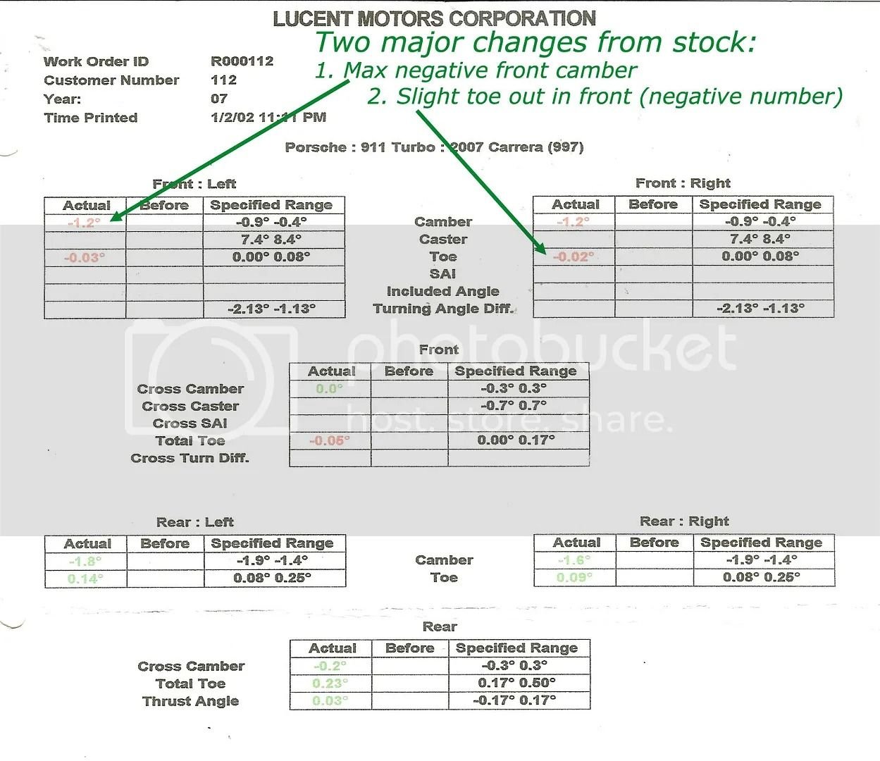

For those in Southern Cal, a shout-out to West End Alignment in Gardena, in case you don't already know about this shop. West End is VERY well known among Porsche enthusiasts, and actually is located close to where I live, but this is the first time I've used the company.
If you are a seasoned veteran, Darin (shop owner) would of course set the alignment to your request, otherwise he would ask what sort of use or expectation you want from the car and recommends a setting. In my case (sporty driving on canyon roads), we settled on:
Front: 1.35 neg camber, 1/32" toe OUT. (Basically the highest negative camber possible in my stock car with Bilstein.)
Rear: 1.65 neg camber, 3/32" toe in.
As a side note, the alignment job thankfully corrected my steering wheel being just a slight hint off center, which is probably not noticeable by most people but bothered me, and my OCD, just a little bit.

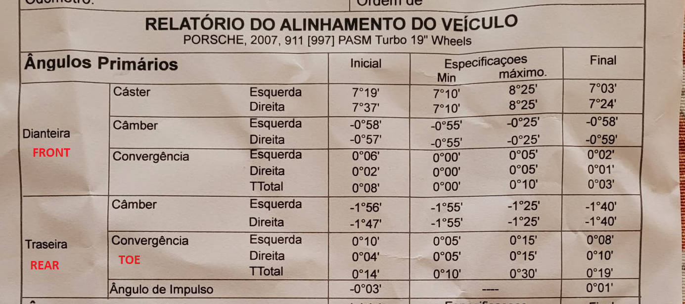

Hello Cannga,
I installed 4 new tyres on my 997 Turbo and got an alignment (result attached bellow), the car feels nice but the steering gets pretty heavy under load (fast cornering), it's not unbearable but compared to a normal or modern car it required a lot more effort. Is this normal? Maybe a result of the increased front camber? I would like to reduce the weight of the steering, if possible.
Thanks!

Sorry but I am no expert to try to diagnose anything, let alone over the internet. I could only tell you that there is not such an increase of effort in my car. If it were me I would ask my tuner to test drive the car.
Just curious - the final front camber -0 degree 58' left and 0 degree 59' right. That doesn't sound like much of an increase over stock no?
Yes it's around -1º degree on both front wheels, it's not a big increase over stock, but it was a big increase over what it was before the values were all over the place.
Got it. I would like to add that if anything adding front negative camber and especially the slight front toe out improves turn-in response and makes my car feel "lighter on its feet," more eager to turn. The steering responsive is more sensitive, subjectively faster, and most definitely does not require more effort. Hope this helps.
