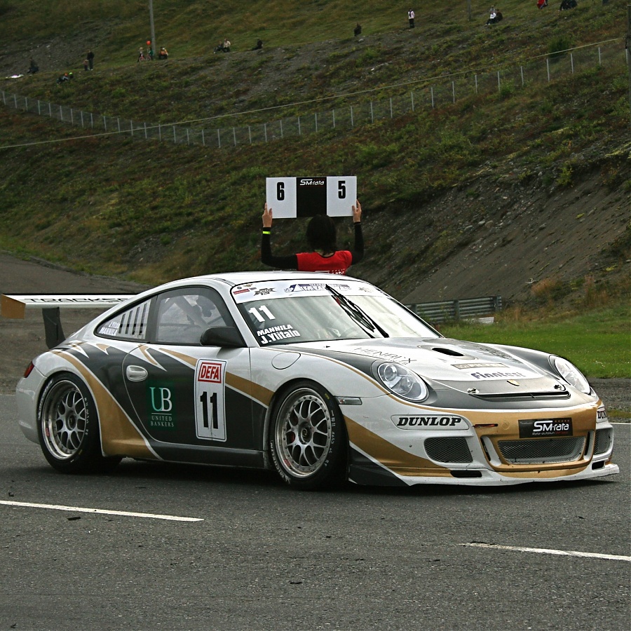

OT - BradPete is that your Cup car in the avatar? Nice livery design! Any bigger pics?
Actually yes... here You go!

awesome!
