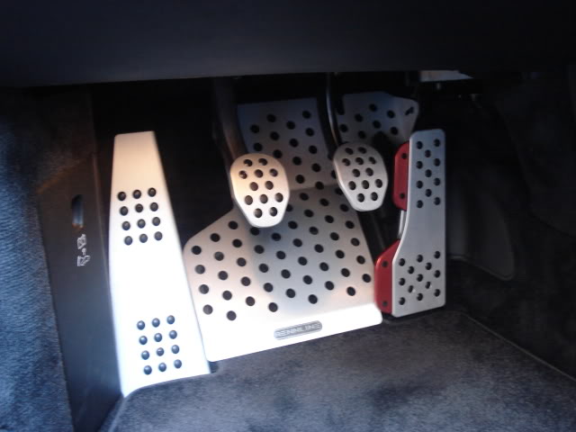

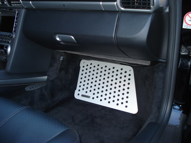

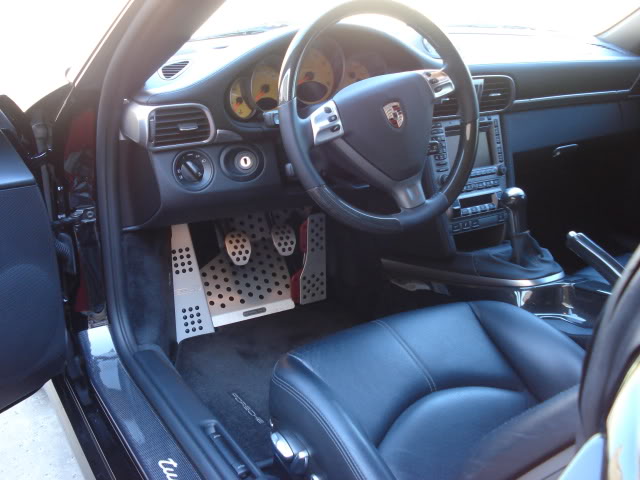

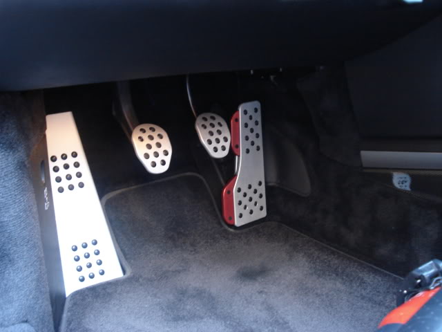

Pedals and floorplates
Got around to installing the floorplates and drove the car a bit today. More contorting and sore knees, but it's done
Pedals without the floorplate
With floorplate. Ended up not drilling into the chassis for the top left hole. Made me too nervous. Just used a strip of velcro along the top edge and voila!
Passenger side
Driving impressions. Just wow. I thought it would make heel-toe a bit easier (which it most definitely does) and that's about it. Mostly 'bling' for the interior. But I don't know what or why, but clutch feel is infinitely improved! My desire to do the GT2 clutch slave cylinder conversion was based on the fact that the pedal had NO feel/feedback. Maybe it's the removal of those rubber covers and replacing it with metal. No idea, but I like it!
