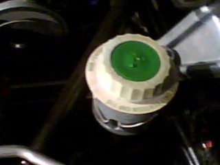

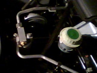

What is this?........
Described in a 911uk forum as "Its the second supply tank for the clutch actuating circuit". I haven't checked my owners manual yet. But while taking off the plastic covers covering everything under the hood tracing the oil leak. I see oil all over the place and a pool of it on the lower left of the battery. Wires and other stuff are covered with oil. The top of this small oil tank is loose, but doesn't seem to tighten. It reads "mineral oil" on it. What is it for and do I need to worry about it leaking or that it leaked?

Mine was just replaced under warranty, I think it's a known issue.

This is it:
On this forum
http://www.rennteam.com
please search for this title:
<TABLE class=detailboxhead><TBODY><TR><TD>HELP PLS: Brake Fluid Leak? </TD></TR></TBODY></TABLE>
by cannga on the 997 Turbo board
Sorry, can't paste the thread directly

txs alcyon - i read the forum notes.
tt surgeon, what was replaced, how long did it take, etc? txs
Old Mar 9, 2009 | 12:15 PM
summoboy's Avatar
Joined: Aug 2008
Posts: 652
Rep Power: 48
summoboy is just really nicesummoboy is just really nicesummoboy is just really nicesummoboy is just really nicesummoboy is just really nice
clutch and slave replaced by dealer under warranty. ~ 4 hours to do.

Hope you meant "clutch and slave cylinders".
Does anyone know what the consequences are if this failure occurs in the middle of nowhere? Is the car still operable?
