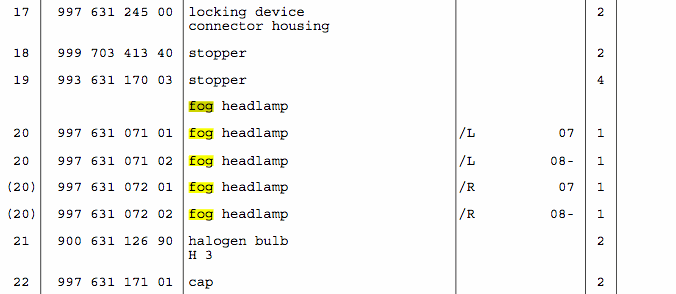

Now I just need to find out if this assembly is sold in parts or only as a whole unit. Thanks bbywu!
I don't see the wire separately, but will check...
Jeez, you're just a wealth of info
Looks like the housing (#22) is a piece unto itself and the wires/grey piece come with the metal electrical bulb connector (#23).
Old Nov 2, 2009 | 09:48 PM
  #33
bbywu's Avatar
Posts: 10,774
From: OR Room 5
Rep Power: 1007
I think 22 comes with the black cap, the grey connector with wires that end with standard wire connectors with plastic covers.
23 is a "repair kit" it comes with the H3 bulb holder, a rubber sheath to hold the wire, and a spring clip.
H3 bulbs go into the holder. They have a single wire with a standard electrical connector (male.) Once placed in the holder, the rubber sheath holds the wire, and the spring clip is used to place the entire unit into the lens.
The wire from the H3 bulb plugs into the female connector in the black cap. On the bottom of the H3 holder is another male connector, and plugs into another female connector in the black cap. Hence, a complete circuit.
Think I got it. If the grey connector is part of the black housing, then I'll need both 22 and 23. Thanks again!
I think you are correct
My pleasure, good luck.
