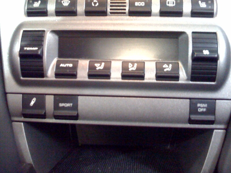

The parts cost about $5300 through SunCoast...it includes the rear deck lid and wing, front lip, and a few other parts. The fan, hydraulics, and mounting hardware needs to be transferred form the stock decklid and wing. You will also need to paint it, and either use Durametric 6.0 or PIWIS to turn off the factory wing or a warning light will go on when you accelerate past 70mph.
You may also want to use the GT3 console to eliminate a "dead" wing deployment button:
