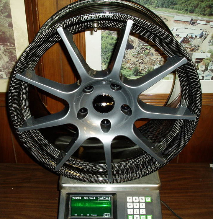

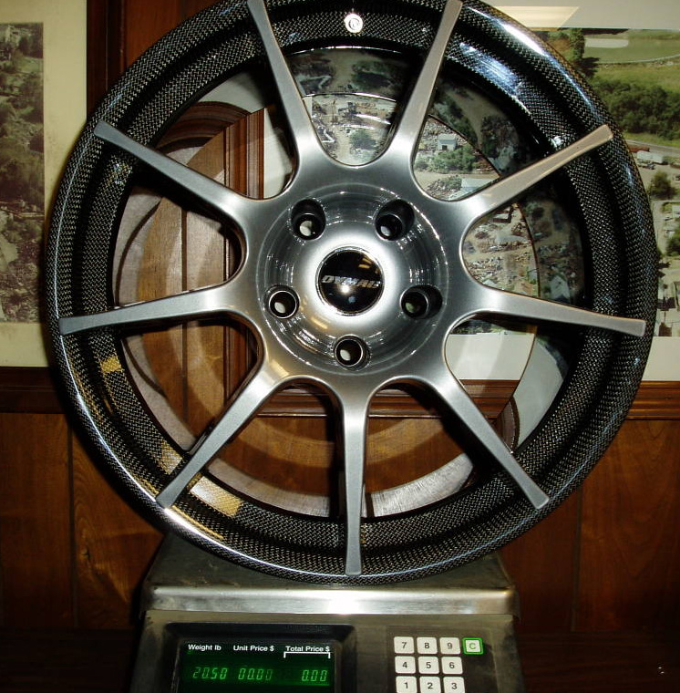

Numbers like the ones you suggest are urban legends.
This is the accurate Dymag weight data, straight from the importer, Bill Koenig:
Dymag Carbon= 7.5kg & 9.12kg (16.5 & 20.05 Lbs) 19x8.5 front and 19x11.5 rear. Very similar to the other carbon manufacturers as well.
As to the Carbon deforming, nothing could be further from the truth. The Dymag carbon structure is stiff beyond belief and has virtually no flex. Thus, all the deformation loads were borne by the bolt-in center. This resulted in some spectacular failures. And chronic air leakage around the center fastening system.
Re the first comment my mechanic had weighted them and that was the result without the bolts & sensors. I guess i ll have to do it again myself.
As for the second re carbon bending etc this came from the MD of the company himself and explained the advantage they have on tracks.
Dont forget that there were a few generations that came with different materials, designs and .. weights.
I am just posting my extensive experience, i have tried almost every single suspension component available and the dymags were by far the one mod that made this heavy car feel like a GT3. And were worth 1-1.5 secs at Paul Ricard vs stock

Please find the dymag weights attached. Every wheel is 2kg until is put on a scale. The weights seem to go with Mike's estimate as well.
