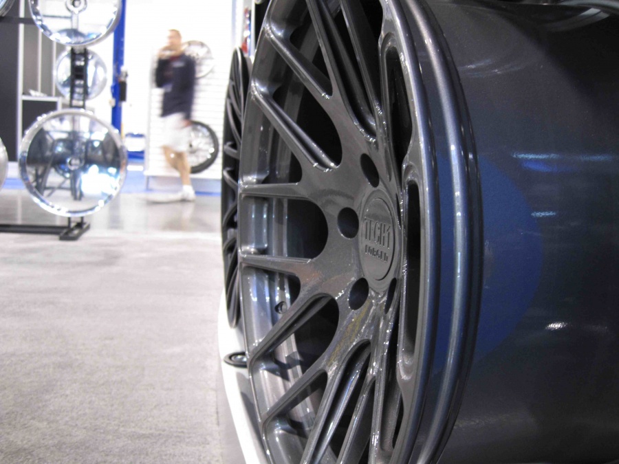

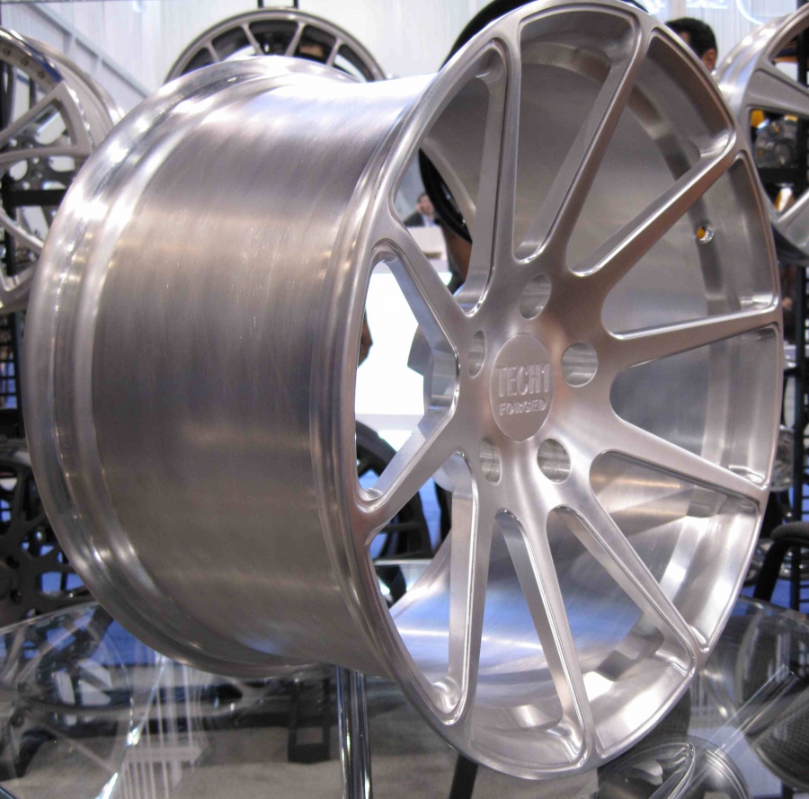

Originally Posted by milou
Can you post some pics pls.
There are some good pictures of the Tech1-109 and 110 on our website:
www.forgedalloysUSA.com
The Tech1-200 series pics I will add here.
This group buy is for any 19 or 20 inch 997 Porsche fitment.
PM me for 996 fitments.
Finish is limited to Matte Black, Satin Black, Gloss Charcoal, Brushed/Clear and Brilliant Silver.
$3995 per set, 4-5 week delivery
PM me with questions.
Mike
