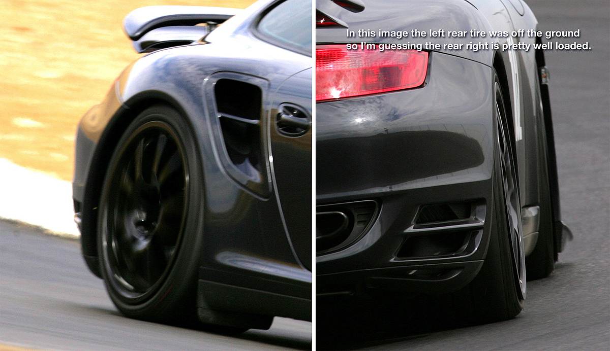

Check out this close-up at speed...19’s with stock 305’s, rear offsets of 44, CMS RS171’s 11.5in rims. After mounting the GT2/GT3RS rims that have an offset of 51 and are 12 inches wide, we feel you could try 315’s (Hoosiers), 325’s would be questionable.
Twenties are terrible for track use...NOTE the sidewall flex on the bottom right rear vs the the top...I think if I had twenties, the rims might be scrapping....

VD, those are some incredible shots! Be careful with 325s on these cars, several guys have had lots of differential trouble, sharky knows the car.
Personally, I would stick with the stock N cup sizes, more than enough street or track, the factory already figured it out for you. I ran my fastest times at the glen with that package with a lot of camber (-1.9 fr and -2.3 rear), no issues whatsoever in the turns, straights or esses.

Awesome pictures. Looks like the rubber was almost pulled off the tire.

Based on the above images, I ended mounting Michelins Pilot Sport CUPs N0 305/30s and 235/35 on the GT2/GT3RS rims.

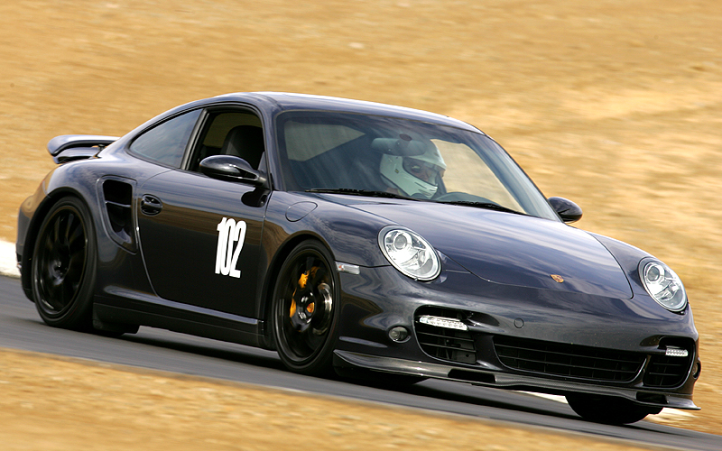

Hey Bonehead, not the greatest picture but this it what it looks like with 12.0x19 inch rear rims (51 offset) and MPSC’s 305/30’s mounted. The fronts are 8.5x19 with 235/35’s. Champion Springs, OEM GT2/GT3RS rims.
This is 11.5x19 offset of 44 CMS RS171’s and Pirelli P Zeros

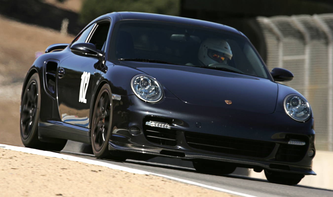

Champion Motorsports Werks1 Carbon Fiber front splitter and Champion 997 TT Sport Springs, which drops the car and stiffens it up, not sure how low, but its pretty low.
Scraping issues...you bet. I have to be very careful and know where I’m going and what the location entry and exits are like. I have yet to rip it off, hit the front of it, or curb it...I’m pretty careful. I’ve had lowered cars before so I have learned a few hard lessons already. As for road use its not bad, just pulling in and out of driveways and business lots/gas stations are always areas of concern. You’ll be safe as long as you remember to angle in and out. It also has aluminum skid plates on the bottom which see and feel a lot of use.
I have been able to navigate through the city (SF) several times, ending up in odd places with some steep *** hills that have very flat bottoms/intersections...its still there and no visible damage...yet!
